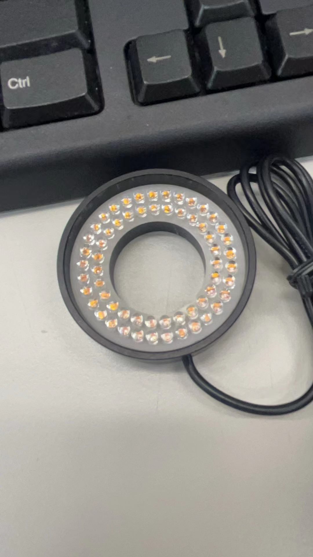

Can Omniverse simulate an LED array in a ring light source (where each LED can be individually set and controlled)?
There is a built-in “Disc Light” function, but it is not specifically for individual LEDs.
Are there any successful cases of this? How is it usually done?
Are there any images or animations available for reference?
