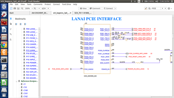

We are connecting a wifi module to TX2-NX module via PCIE interface.For the module we need sleep clock to be fed as input,CLK_32K_OUT from module is supposed to generate that clock,but when probed it is not coming.I have enabled this pin in the pinmux sheet also.
Do i need to configure this pin in any other part of code to enable CLK_32K_OUT pin?
Please give me some pointers on it.

Attaching the schematic for PCIE connection on both Tx2-nx module and wifi chip
side

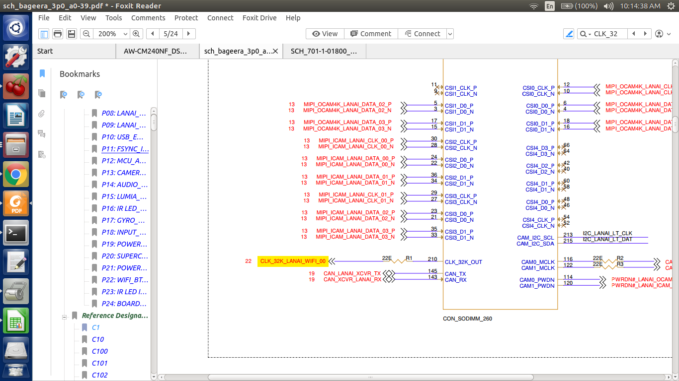

Can you clarify where is your “sleep clock” mapping to? CLK_32K_LAINAI_WIFI_00?
Which pin do you connect on TX2-NX for this?
Hi Wayne,The highlighted pin is the pin connected to CLK_32K_LANAI_WIFI
