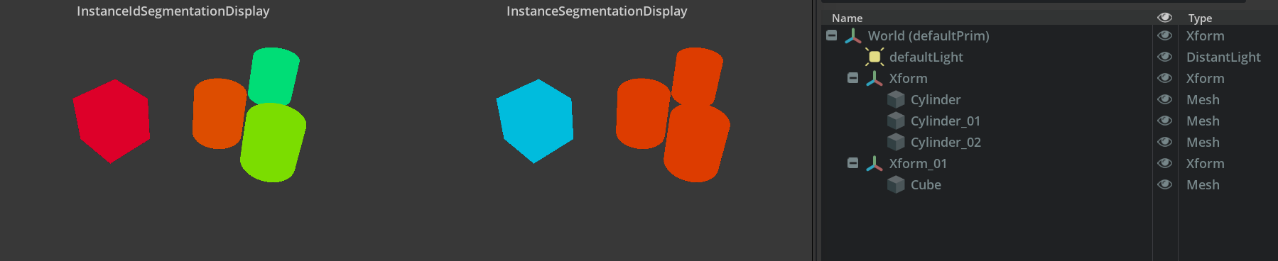

Hi, I notice that in the new update for Replicator, when writing Instance segmentation masks, the new default is for the segmentation to output raw. How would I revert it back to parsed? Is that a parameter I can set in a custom writer?
To clarify, in the given Synthetic Data visualizer in the attached image, is what I mean between raw and parsed instance segmentation.

Hi @mfoo , if I understand correctly, you want the Xform to be classfied as a single instance right?
