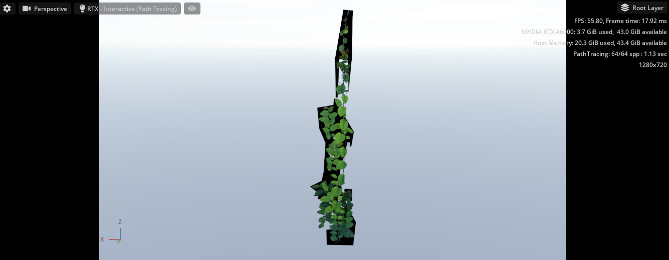

Second issue is regarding the use of opacity textures when using the path tracer renderer in Create 2022.1.1, when zoom in somewhat closer to object, the path tracer renderer shows obvious black opacity map artifacts while the Iray and real time renderer do not. I retest the same issue using Create 2021 path tracer renderer and it also does show minor black opacity map artifacts but only when zoom in extremely close to object.
I was testing some leafs assets with opacity map for the opacity issue and for the texture streaming issue is very apparent for texture with texts . Thank you.

Hi @PhilippeR ,
Another opacity issue I encountered in Create 2022.1.2, RTX real time is working but path-trace is not working.

Hi @PhilippeR ,
Image file format I have used is both Jpg and Png and both showing the same opacity artifact on path tracer.
Currently on Quadro desktop and notebook driver release 510 , version 512.59 release date 04/26/2022.
Just using omniPBR for material.
Could you export the mdl and attach it here?
Also if you could export your render settings; in render settings, in the top right, click the button, save settings.
It could help me isolate the issue.
