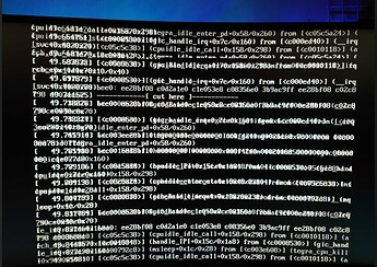

I have 2 TK1 kit which has the same issue when flashing R21.8 (previously it running R21.4)
The Host is Ubuntu 20.04.3 LTS. Flash log complete successful:

*** The target ardbeg has been flashed successfully. ***
Reset the board to boot from internal eMMC.
i dont have a console cable (i will try to find one) here are some screenshots of R21.4 and R21.8 boot loop.

The symptom same as this topic Jetson tk1 stuck in boot after flashing
Thank you for your help in advance!
