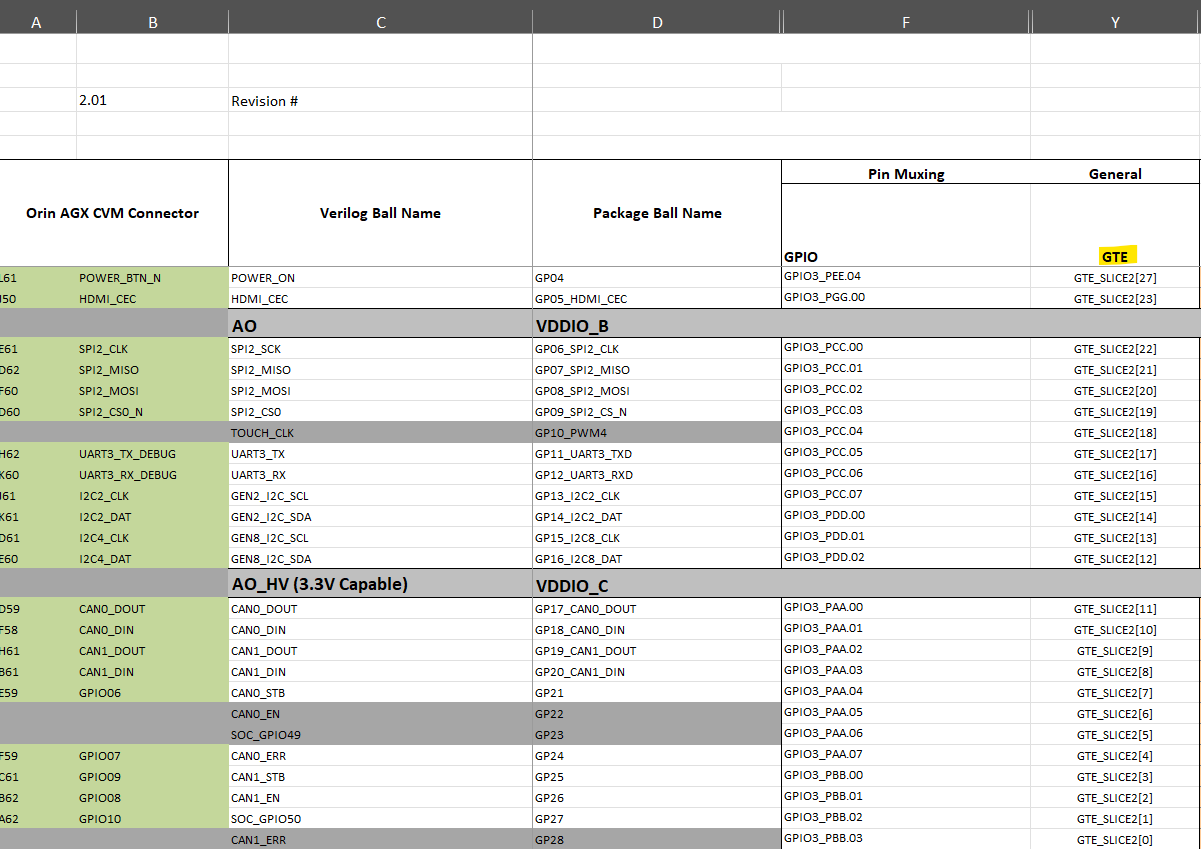

Yes I am already using the GTE to get timestamps of the GPIO events but the timestamps drift over time relative to system time. I believe the GTE uses the TSC as the hardware timestamping clock so I’m looking to discipline the TSC to prevent it from drifting over time. Note that I have system time disciplined using PTP so I want to synchronize the TSC to PPS so that both clocks are synchronized to effectively the same external source.
I’ve also already tried to use the NVPPS module for this but it did not work. I tried all 5 of the supported MAC interfaces (mgbe0-3 and eqos0) and while NVPPS was able to read timestamps from the interfaces and the TSC, the TSC was not still not being synchronized to the PTP signal. I checked the TSC_LOCKING_STATUS_0 register for the CAPTURE_DIFF_COUNT to see if the TSC was registering any capture events from the reference signal but it always reported 0 and I still saw the timestamps drift.
I’m hoping to try using TSC_CAPTURE_CONFIGURATION_GPS_0 instead of TSC_CAPTURE_CONFIGURATION_PTX_0but need to know what AON GPIO lines the TSC can use as a reference signal and what is the mapping from AON GPIO line to the TSC_CAPTURE_CONFIGURATION_GPS_0src_select configuration.
Any of the spare / unused GPIO pins from AON controller can be used.
LOCKING_CONFIGURATION.SRC_SELECT=0 should select the GPS (or GPIO) based signals.
CAPTURE_CONFIGURATION_GPS.SRC_SELECT[15:0] selects the particular GPIO signal.
The mapping is same as GTE (column Y) mapping in pinmux spreadsheet as following.
