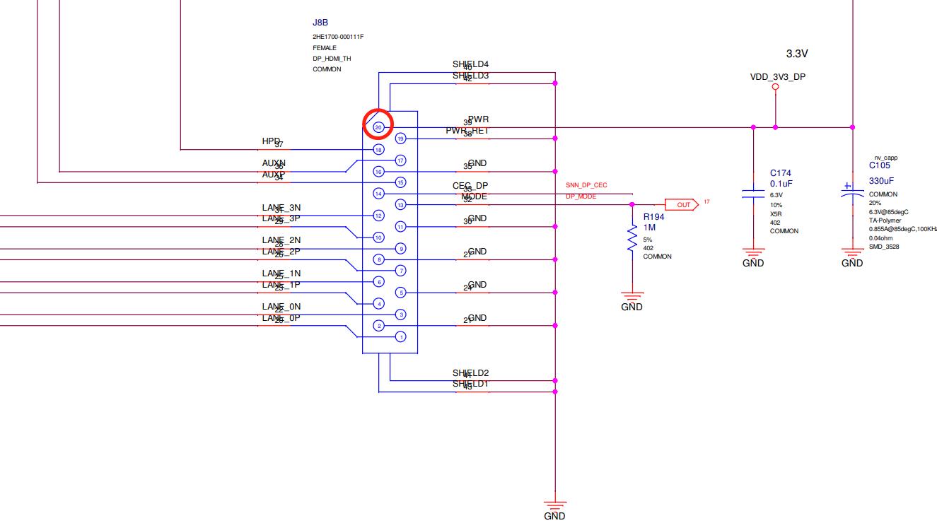

We want to use an eDP interface lcd for Xavier NX,
the eDP LCD has two lanes : lane0 and lane1, aux_ch, hpd,
use the Jetson_Xavier_NX_Carrier_Board’s DP port for testing,
connect eDP lcd’s lane0 , lane1, aux_ch, hpd, and vdd to carrier board DP port’s LANE0, LANE1, AUX, HPD, and PWR, LCD’s backlight always on, after system power on, no display on the LCD, and the dmesg log and LCD spec attached bellow, please give some advice, thanks.

Tegra fails to read the EDID from your panel. Please check your hardware design for this part.

Thanks, I find this, and checked the AUX_ch connect OK.
I use FPC to DP plug converter(FPC to eDP LCD and DP plug to carrier board DP port), so the carrier board DP’s pin 13, and pin 14 connect to GND, does this matter?
It depends on your eDP device feature. Pin 13 has no effect to Jetson. DP_MODE pin is connected to GND on carrier board.
Also, you can probe the AUX lines with scope to observe if any communication on it.
If your power source is a always-on system power with 3.3v, please also check the device tree setting of vdd-dp-pwr-supply.

Hi, your test setup is by such wires not cable? I’m afraid that its signal quality will be not so good. For AUX connection, it should work if your device power on correctly and AUX connection is correct. And we are not sure if your such 2 lane eDP is supported as you can see in DG that it is 4 lane connector on devkit.
So, please try to make the AUX of the LCD work firstly.
