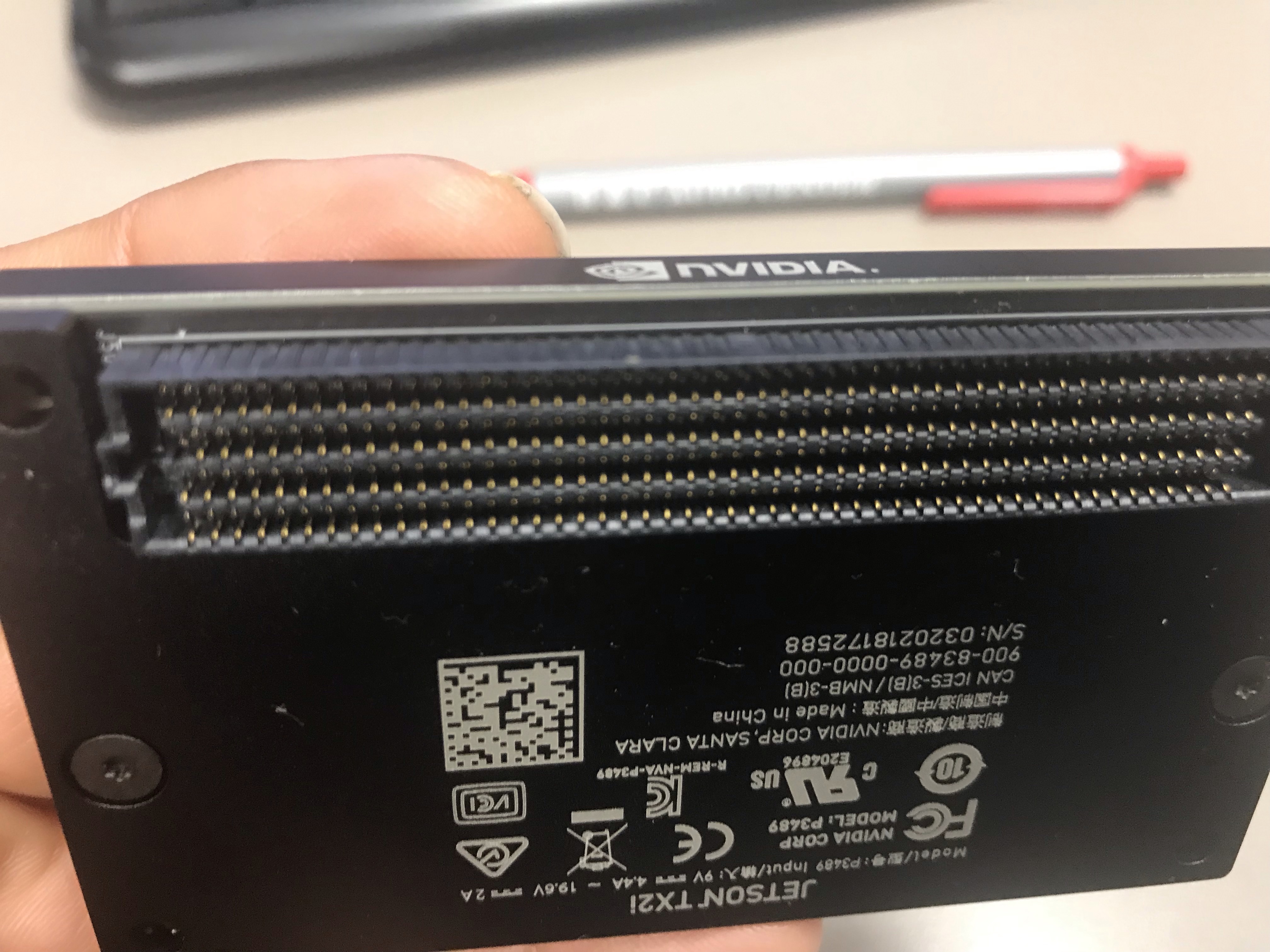

Tx2i not booting in normal or force recovery mode
One of my Tx2i unit does not boot at all. Started seeing issue with this unit couple weeks back. I was able to boot the unit in force recovery mode and flash the image successfully that time. But after flashing it won’t boot. The console logs showed some crash -

Just saved the logs but didn’t debug further at that point. Started looking at the unit now to debug the problem but can’t boot the unit in normal or recovery mode and I can’t connect to console. Here are the messages I see in the dmesg for the UART cable on my PC -
$ dmesg | grep tty
[109894.069995] ftdi_sio ttyUSB0: error from flowcontrol urb
[109894.070241] ftdi_sio ttyUSB0: FTDI USB Serial Device converter now disconnected from ttyUSB0
[109894.561836] usb 1-3: FTDI USB Serial Device converter now attached to ttyUSB0
[109909.657311]  [<ffffffff81506cf1>] tty_ioctl+0x5f1/0xca0
[109909.657315]  [<ffffffff81503db1>] ? tty_write_unlock+0x31/0x40
[109909.657317]  [<ffffffff8150e046>] ? tty_ldisc_deref+0x16/0x20
[109917.548640] ftdi_sio ttyUSB0: failed to get modem status: -110
[109917.550486] ftdi_sio ttyUSB0: error from flowcontrol urb
[109917.551029] ftdi_sio ttyUSB0: FTDI USB Serial Device converter now disconnected from ttyUSB0
Not sure what is going on and how to debug the issue. Any suggestion ?
The first error seems to be from Xorg (the GUI). The serial UART issue seems to be flow control.
What serial console program are you using? Can you tell the program to not use flow control?
If the GUI is failing, then ssh should still work. Probably CTRL+ALT-F2 would get you to a text console…does that work? If either ssh or text console work, what do you see from:
sha1sum -c /etc/nv_tegra_release
Thank You linuxdev for your response regarding the issue with my Tx2i module and apologies for not responding for so long. Got busy finishing some high priority task at hand using the other Tx2i module I’ve.
On Friday when I connected this module back to the carrier board and booted, it came up just fine - the display, UART everything and I was able to use it fine. Here is the sha1sum output that you asked for -
nvidia@tegra-ubuntu:~$ sha1sum -c /etc/nv_tegra_release
/usr/lib/aarch64-linux-gnu/tegra/libnvosd.so: OK
/usr/lib/aarch64-linux-gnu/tegra/libnvmmlite_image.so: OK
/usr/lib/aarch64-linux-gnu/tegra/libnvomx.so: OK
/usr/lib/aarch64-linux-gnu/tegra/libnvmedia.so: OK
/usr/lib/aarch64-linux-gnu/tegra/libnvmmlite_utils.so: OK
/usr/lib/aarch64-linux-gnu/tegra/libglx.so: OK
/usr/lib/aarch64-linux-gnu/tegra/libscf.so: OK
/usr/lib/aarch64-linux-gnu/tegra/libnvexif.so: OK
/usr/lib/aarch64-linux-gnu/tegra/libnvrm_gpu.so: OK
/usr/lib/aarch64-linux-gnu/tegra/libnvtx_helper.so: OK
/usr/lib/aarch64-linux-gnu/tegra/libnvfnetstorehdfx.so: OK
/usr/lib/aarch64-linux-gnu/tegra/libnvmm_parser.so: OK
/usr/lib/aarch64-linux-gnu/tegra/libnvrm.so: OK
/usr/lib/aarch64-linux-gnu/tegra/libnvmm_contentpipe.so: OK
/usr/lib/aarch64-linux-gnu/tegra/libnvos.so: OK
/usr/lib/aarch64-linux-gnu/tegra/libnvtnr.so: OK
/usr/lib/aarch64-linux-gnu/tegra/libnvimp.so: OK
/usr/lib/aarch64-linux-gnu/tegra/libnvfnet.so: OK
/usr/lib/aarch64-linux-gnu/tegra/libnvavp.so: OK
/usr/lib/aarch64-linux-gnu/tegra/libnvmmlite_video.so: OK
/usr/lib/aarch64-linux-gnu/tegra/libnvfnetstoredefog.so: OK
/usr/lib/aarch64-linux-gnu/tegra/libnvodm_imager.so: OK
/usr/lib/aarch64-linux-gnu/tegra/libnvjpeg.so: OK
/usr/lib/aarch64-linux-gnu/tegra/libnvtvmr.so: OK
/usr/lib/aarch64-linux-gnu/tegra/libnvidia-egl-wayland.so: OK
/usr/lib/aarch64-linux-gnu/tegra/libnvdc.so: OK
/usr/lib/aarch64-linux-gnu/tegra/libtegrav4l2.so: OK
/usr/lib/aarch64-linux-gnu/tegra/libnvmm.so: OK
/usr/lib/aarch64-linux-gnu/tegra/libnvapputil.so: OK
/usr/lib/aarch64-linux-gnu/tegra/libnvcameratools.so: OK
/usr/lib/aarch64-linux-gnu/tegra/libnvcam_imageencoder.so: OK
/usr/lib/aarch64-linux-gnu/tegra/libnveglstream_camconsumer.so: OK
/usr/lib/aarch64-linux-gnu/tegra/libnvmm_utils.so: OK
/usr/lib/aarch64-linux-gnu/tegra/libnvomxilclient.so: OK
/usr/lib/aarch64-linux-gnu/tegra/libargus.so: OK
/usr/lib/aarch64-linux-gnu/tegra/libnvwinsys.so: OK
/usr/lib/aarch64-linux-gnu/tegra/libargus_socketclient.so: OK
/usr/lib/aarch64-linux-gnu/tegra/libnveglstreamproducer.so: OK
/usr/lib/aarch64-linux-gnu/tegra/libnvll.so: OK
/usr/lib/aarch64-linux-gnu/tegra/libargus_socketserver.so: OK
/usr/lib/aarch64-linux-gnu/tegra/libnvrm_graphics.so: OK
/usr/lib/aarch64-linux-gnu/tegra/libnvcolorutil.so: OK
/usr/lib/aarch64-linux-gnu/tegra/libnvddk_2d_v2.so: OK
/usr/lib/aarch64-linux-gnu/tegra/libnvtestresults.so: OK
/usr/lib/aarch64-linux-gnu/tegra/libnvcamerautils.so: OK
/usr/lib/aarch64-linux-gnu/tegra/libnvcamlog.so: OK
/usr/lib/aarch64-linux-gnu/tegra/libnvparser.so: OK
/usr/lib/aarch64-linux-gnu/tegra/libnvddk_vic.so: OK
/usr/lib/aarch64-linux-gnu/tegra/libnvmmlite.so: OK
/usr/lib/aarch64-linux-gnu/libv4l/plugins/libv4l2_nvvidconv.so: OK
/usr/lib/aarch64-linux-gnu/libv4l/plugins/libv4l2_nvvideocodec.so: OK
/usr/lib/xorg/modules/drivers/nvidia_drv.so: OK
/usr/lib/xorg/modules/extensions/libglx.so: OK
Today morning though it failed to boot again. No display, no UART. I usually use minicom, the flow control is disabled but I still can’t connect. CTRL+ALT-F2 does nothing. Not sure whats wrong, its behaving inconsistently. Any more ideas ? Thanks

I was using TX2i and Nvidia carrier board and the FTDI serial connector connected to J21 header to access console when I collected the above logs.
Last week, tried disconnecting FTDI, keyboard, mouse and ethernet cable (so just power supply and HDMI/display connected). The unit turned on and I could see the display with plain blue screen (no Ubuntu desktop screen) and only the ‘Chromium Web Browser’ icon on the top left, no taskbar or any menus (looked incomplete). Rebooted and it came up exactly as before. The inconsistency in behavior was still there.
Today I unplugged the module from the carrier board and was checking the pins on the back, it seemed that one of the pins on the extreme left, middle row) seem to be missing/broken (see attached image). Not sure how that happened. But that probably may be the reason for the issues I’ve been seeing?
What are my options here ? Can I send it back and Nvidia can help fix ?
Yes, you can RMA. Search for “RMA” near the top of this for information:
