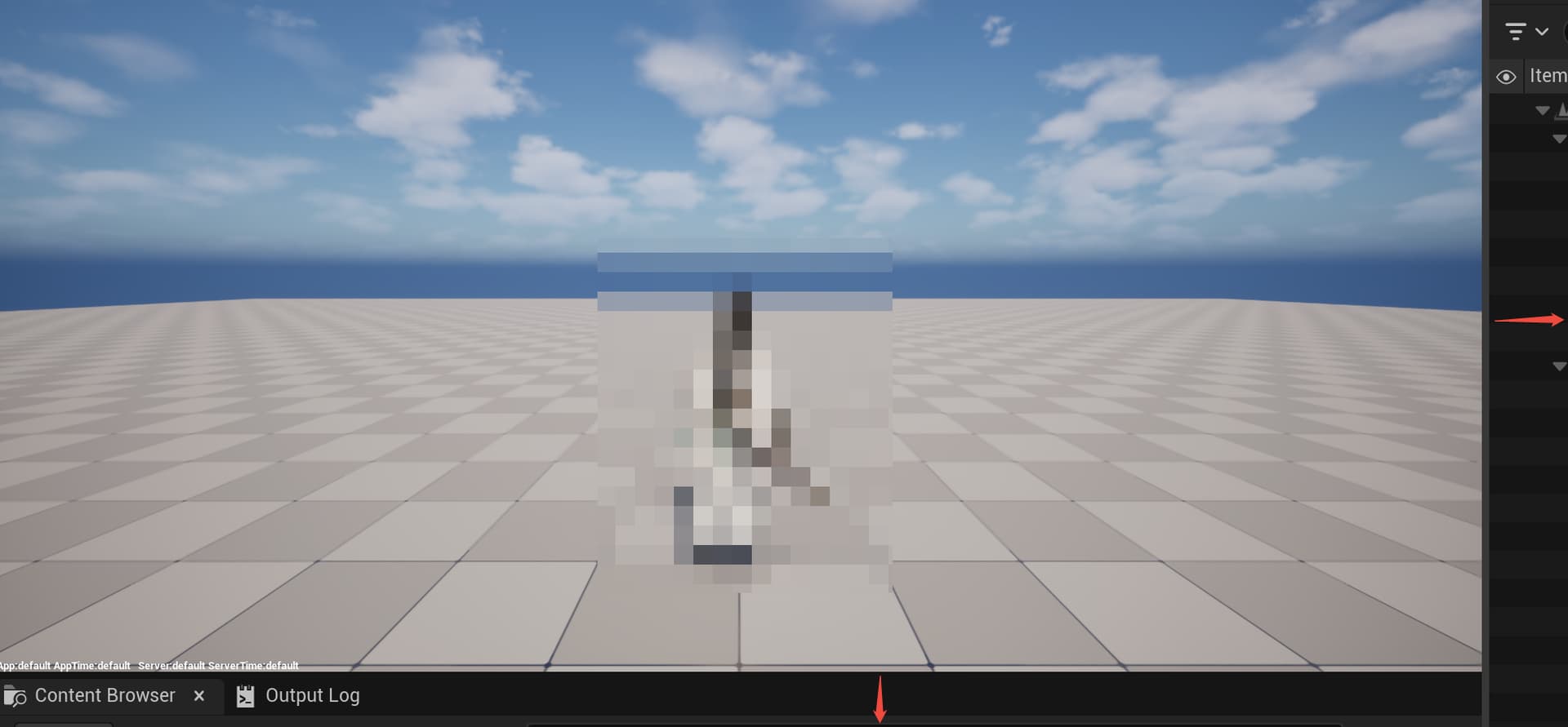

When the editor is running(dlss is running), dragging the game window or repeatedly pressing F11 to full screen will occasionally cause the GPU to crash. Is there any solution? I can change the source code.
If i turn off r.RHICmd.ParallelTranslate.Enable, this will not happen.

Thanks for your reply! Here are more information about the crash(one log file and two captures of the minidump).
In the log file you can see some of the resources are destoryed, which cause the gpu crash.
And if i release the DLSSFeature manually after NGX_D3D12_EVALUATE_DLSS_EXT is called, that will cause GPU crash too, but in this case the log shows all resources are destoryed. I wonder if I need to add more synchronization points but i don’t know how to do.
  1. this bug can be triggered by scale the editor viewport
  2. from the log often 2 frame postprocess submit at the same time:
  3. from the gpu dump file it seems that input/output of dlss have be evicted by DX12 ResidencyManager
  4. local test close ResidencyManager in dx12 or make input/output of DLSS residency fix this problem in my computer
