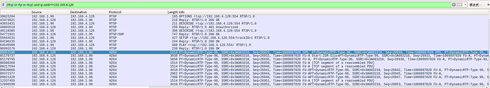

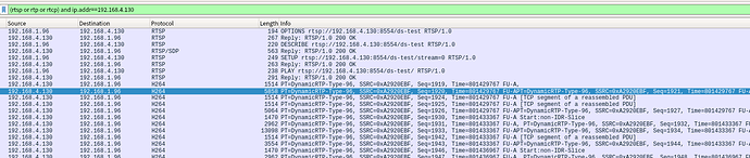

I’m analyzing the deep reasons。During the test, I found that the output stream generated by Deepstream had no SPS and PPS information, I tried to modify the code to add this information,but it didn’t work.
I tried to add:
g_object_set (G_OBJECT (bin->encoder), “insert-sps-pps”, TRUE, NULL);
g_object_set (G_OBJECT (bin->rtppay), “aggregate-mode”, “zero-latency”, NULL); // gstreamer1.14.5 do not contain this attribute
g_object_set (G_OBJECT (bin->rtppay), “config-interval”, -1, NULL);
But the SPS and PPS data are still not generated。This is the reason why ffmpeg reports an error and cannot achieve zero delay opening.

The Source RTSP
The Deepstream RTSP
There is sps and pps with every idr frame when you enable “insert-sps-pps”. The default idr interval is 256 frames. There is no way to achieve “zero delay” even it is an only idr stream because there will be network delay anyway. You can try “idrinterval” property to reduce the duration between idr frames.
Maybe my translation is not accurate, the “zero delay” means that the stream is displayed within one second, because I need to use WebRTC + FFMPEG + Deepstream for the client presentation
So you need very small idr interval.
