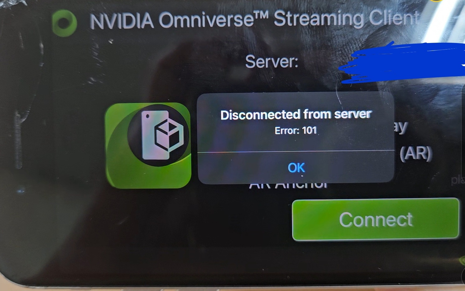

I attempted to run the VR example in Isaac Sim (version 4.5.0) on Windows 11 using a GeForce RTX 3060 (driver version 531). After launching isaac-sim.xr.vr.bat and starting the VR session, I connected to the simulation using the NVIDIA Omniverse Streaming Client on an iPhone.
However, the simulation either fails to render properly or crashes shortly after connecting. The log suggests there is a GPU memory allocation failure, and I also see issues related to DLSS resolution being too low and invalid camera settings (Camera tangentY min and max are invalid).
Steps to Reproduce
  1. run: isaac-sim.xr.vr.bat
  2. Strat VR
  3. Connect: Nvidia Oniverse Streaming Client in iPhone

2025-05-12 05:08:52 [76,376ms] [Error] [omni.kit.xr.core.plugin] Camera tangentY min and max are invalid: 0.000000->0.000000
2025-05-12 05:08:52 [76,388ms] [Warning] [rtx.postprocessing.plugin] DLSS increasing input dimensions: Render resolution of (176, 104) is below minimal input resolution of 300.
2025-05-12 05:08:52 [76,391ms] [Warning] [rtx.postprocessing.plugin] DLSS Skipped: Target resolution below 64x64.
2025-05-12 05:08:52 [76,421ms] [Error] [carb.graphics-vulkan.plugin] Out of GPU memory allocating resource ‘MemoryManager-allocate’ [size: unknown]
2025-05-12 05:08:52 [76,421ms] [Error] [carb.graphics-vulkan.plugin] Failure injector rule to repro:
debugName=“MemoryManager-allocate”,
2025-05-12 05:08:52 [76,423ms] [Error] [carb.graphics-vulkan.plugin] VkResult: ERROR_OUT_OF_DEVICE_MEMORY
2025-05-12 05:08:52 [76,423ms] [Error] [carb.graphics-vulkan.plugin] vkAllocateMemory failed for flags: 2.
2025-05-12 05:08:52 [76,423ms] [Error] [gpu.foundation.plugin] Unable to allocate buffer
2025-05-12 05:08:52 [76,423ms] [Error] [gpu.foundation.plugin] Buffer creation failed for the device: 0.

Hi there and thanks for your post. I am going to be honest, a 3060 is just not powerful enough. It is only have 8gb of vram, it barely has enough power to display the image on the monitor, let alone pipe that image in realtime to second location, like your iphone. If you have the 12Ggb version then maybe. We really recommend at least a 3080.
If it is working normally without trying XR streaming, you are probably already maxed out with vram. If it is crashing everytime you try to stream, then this is likely because you are out of memory.
