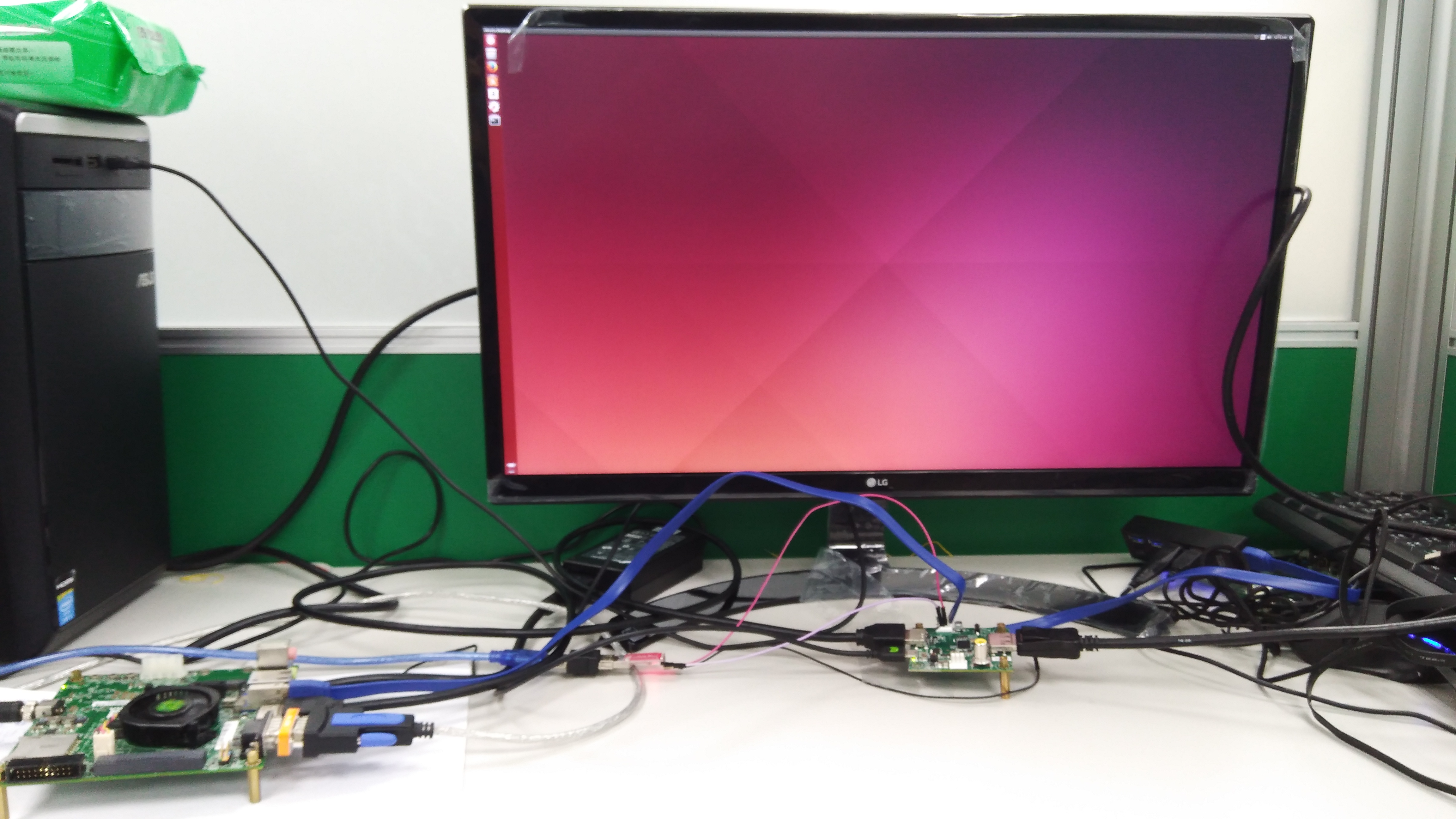

Hi All,
I got a hdmi-to-dp reference board and tested it with jetson TK1.
I found when I set the resoultion to 3840x2160, the timing values of hdmi port would be unstable as well as our customized board.
So I think there might be some timing problem in hdmi port when resolution is high.
cat_tegradc1_mode.txt (265 Bytes)
cat_tegradc1_regs.txt (13.8 KB)
hdmi-to-edp-messages.txt (977 Bytes)
edid.txt (1.04 KB)
Hi FrankPCP,
How about directly connect a 4K@30 HDMI monitor to tk1 board? Is the signal also unstable?
Hi WayneWWW,
I test two 4k monitors with Tk1 board. One is LG 24UD58, the other is ASUS PB279Q.
Please refer to link below for specifications.
http://www.lg.com/us/monitors/lg-24UD58-B-4k-uhd-led-monitor
No issues occur in testing with LG 24UD58. Images output is OK and no blur images.
But when I test Tk1 with AUSU PB279Q, no images output on monitor.
Because I don’t have HDMI analyzer, I can’t measure the timing values of hdmi port.
I am not sure if this is caused by wrong timing value.
Do you have HDMI analyzer or can you see what’s wrong with hdmi port from attached logs?
