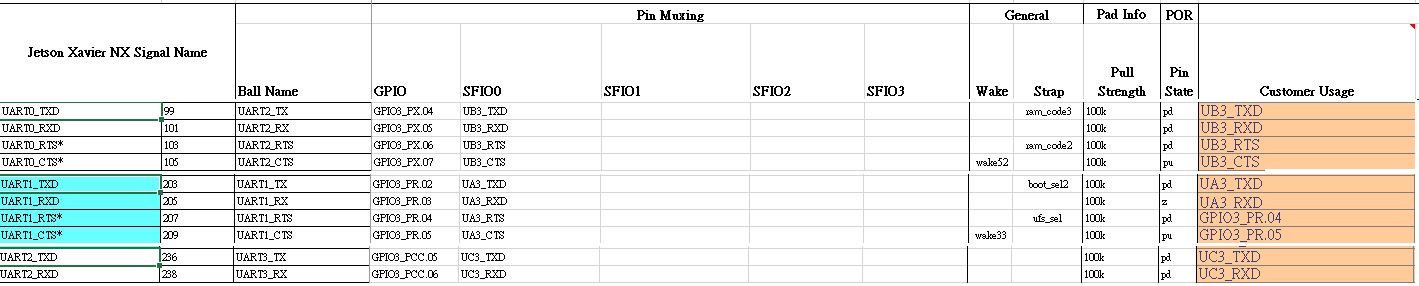

As I know in the Xavier NX,
the ttyTCU0 is belong the UART2(SFIO : UC3).
the ttyTHS0 is belong the UART1(SFIO : UA3).
But which one interface will belong the UART0(SFIO : UB3)? ttyTHS1? ttyTHS4?
Is the UART0 need another configuration for device tree or any other setting??
Best Regards,
MOMO Chen

Dear Jerry,
Thanks for your reply kindly.
There is my confused further.
How could we know the 3100000/3110000/3140000 which mapping to UART0/1 excatly?
Best Regards,
MOMO Chen
Dear Jerry,
Is that like below?
Signal Name		Ball Name		SFIO		Device Tree
UART0			UART2			UB3			serial@3110000	ttyTHS1
UART1			UART1			UA3			serial@3100000	ttyTHS0
UART2			UART3			UC3			serial@c280000	ttyTCU0
Best Regards,
MOMO Chen
hello momo_chen,
yes, that’s the correct mappings.
note, it’s software driver to register ttyTHS* as serial interface, you should always check kernel logs for the mappings for confirmation.
