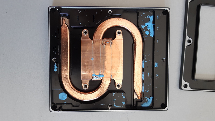

I was wondering if there is any specific requirement for mounting orientation the of the module in relation to gravity (x,y,z orientation)?
I haven’t found any info about this in documentation so can I assume the module can be mounted in any orientation?
Orientation shall be for sure irrelevant for electronics, but I’m asking because of the heatpipe inside the module. Does this heatpipe has any required/optimized orientation to gravity?

The question is if there is requirement/recommendation how the module shall be oriented in relation to gravity vector. This is related to the heatpipe used - does the direction of gravity vector has any effect on the medium that circulate inside the heatpipe?
or any other effect on the thermal design of the SoM
in example we’re simply interested if it’s ok to install SoM in other durection that when Samtec connector is facing down? ie. Samtec facing up or to the side?

Heat flow through metal is not impacted, much, by gravitational field, and none of the cooling depends on internal airflow, so orientation should have little impact - unless you have designed a passive heatsink that requires convection currents to pull air through it. The module itself won’t care about orientation.

Have you looked at the Thermal Design Guidelines document? It’s available for download and goes through a lot of detail on how to design a thermal interface. If you look closely at the assembly (the 3D model is also available for download) and the TDG, you will realize there is no heat-pipe.
FWIW, heat-pipes are also fairly immune to gravity - it’s not about ‘warm air rising’, it’s about water evaporating into a space from the hot component, and condensing from that volume where the fins are cooled - that condensed water is wicked back to the hot surface. There is no gravitation required for this, it will work in 0G.

For the other comments: I humbly disagree - there is heatpipe inside the module (take a screwdriver and have a look if you have doubts) and also some of the liquid/vapor phase change heat pipes has dependency on vector of gravity (and it’s nowhere documented what type is used here)
points out that there is only a thermal transfer plate (TTP) in the module - no heatpipes. The dev kit uses a different thermal solution. All this information about the module is available and it is clearly described in the thermal design guidelines document. You can add your own heat pipe solution.
I’ve tested heat pipes in various orientations and the difference in cooling was not measurable. This may not be the case for all heat pipes, but keep in mind that it’s really hard to get convection currents caused by temperature differentials inside a 1mm tube that’s several cm long. Circulation in there is really driven by the phase change cycle.
What is then this if not heatpipe? :-)
Lol. Yes, I mistook the statement that the cooling interface for the module was different than the dev kit to indicate that there is no heat pipe. But looking again at the TDG, there’s an unlabeled part in the assembly which is almost certainly a heat pipe.
Regardless, with capillary action drawing the fluid along the inner surface (through scintered metal) of the tubes, and phase change driving the circulation, physical orientation of the module would be unimportant. Orientation of the dev kit matters for air-flow.

There is water in the heat pipe, which will evaporate and move to the cooler extremities of the pipe. The heat pipe acts as a sprint to minimize the TIM bond line between the die and the copper plate which also allows a good thermal connection of the Tegra chip to the TTP. There are also direct connections between the memory and power supply inductors to improve thermal dissipation.
With regard to the orientation there are two heat pipes both in a U shape so I don’t believe that there is much change in thermal performance driven by the orientation of the device, but will confirm (update: confirmed orientation should not be an issue).
The biggest impact on thermal performance is the actual load running on the Tegra chip.
Is it correct that the water will always be in liquid phase and that there is no dependence upon vapor/liquid convection?
It’s liquid until it evaporates, that’s the whole idea of heat pipes. It’s not based on convection: fluid evaporates at the hot end and condenses at the cool end. That cycle drives the movement. The liquid is wicked by capillary action back to the hot surface.
The wikipedia article on heat pipes is very informative - including that they’re used in space applications where there is no concept of up or down.
