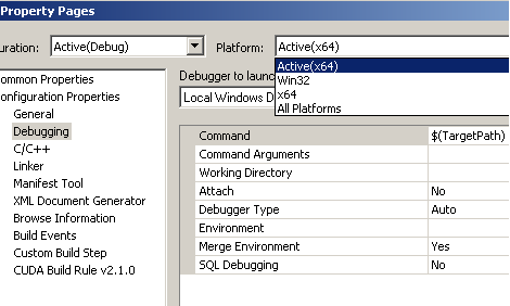

I’m using the “full” Visual Studio @ Windows XP x64 and I also have this problem:
------ Build started: Project: template, Configuration: Debug Win32 ------
Performing Custom Build Step
template.cu
tmpxft_00000438_00000000-3.gpu
tmpxft_00000438_00000000-7.gpu
tmpxft_00000438_00000000-3.c
tmpxft_00000438_00000000-12.i
Compiling...
template_gold.cpp
Linking...
LINK : fatal error LNK1181: cannot open input file 'cutil32D.lib'
Build log was saved at "file://d:\CUDA_64\NVIDIA CUDA SDK\projects\template\Debug\BuildLog.htm"
template - 1 error(s), 0 warning(s)
This is with CUDA 1.1.
There is, in fact, no cutil32D.lib file in my CUDA dirs. Should there be one?
EDIT: Heh, stupid me. I was trying to compile for Win32. If you guys haven’t tried, set the platform to x64 ;) Worked for me.

Be sure to select the project or solution configuration to build for x64. I don’t have a 64b Windows installed right now, so from memory (and from how it looks in Win32), next to the green “debug” arrow on the main toolbar there’s a dropdown menu (hover-text “Solution Configurations”) from which you can select “Relase”, “Debug”, “EmuRelease” or “EmuDebug”. And then to the right you have another one (hover-text “Solution Platforms”) from which you select to target either Win32 or Win64. If that doesn’t work (or if somehow you don’t have this toolbar visible), go to project properties, Linker, Advanced and set Target Machine appropriately (X64). Your mileage may vary, I don’t have XP64.

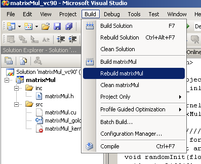

I had the same problem and searched for a long time…
first change to 64 Bit
second rebuild your project
[b]first change to 64 Bit
second rebuild your project [/b]
[attachment=11928:it_works.png]
[attachment=11929:Rebuild.png]
Finally, I found what is going wrong. The visual studio does not install 64 bit compiler by “default”. We mush select “full”.
