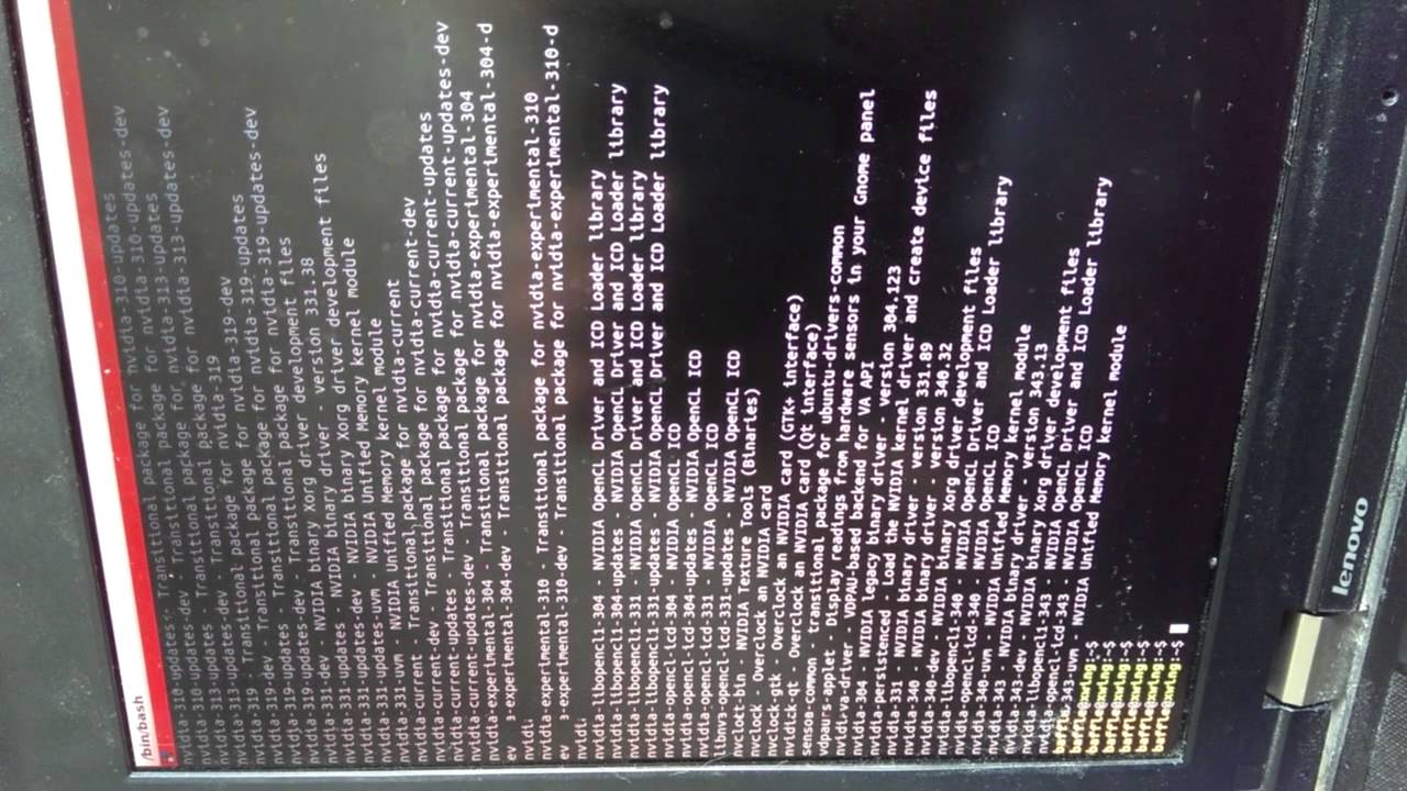

I’m not certain if this is the same problem as I am seeing, I’ve posted a small video that shows how it looks on my screen:
This happens on my Lenovo Thinkpad W520 with the NVidia GF106GLM [Quadro 2000M] card.
I’ve had this problem on Ubuntu 12.04 and 14.04 with all drivers above 3.31 if memory serves me right.
In the video it seems to offset parts of the screen just slightly, but sometimes I will see content that should be offscreen, like old contents from the terminals scrollback buffer.
I randomly get this kind of corruption in all applications.
Is this the same as other people in this thread is seeing?
