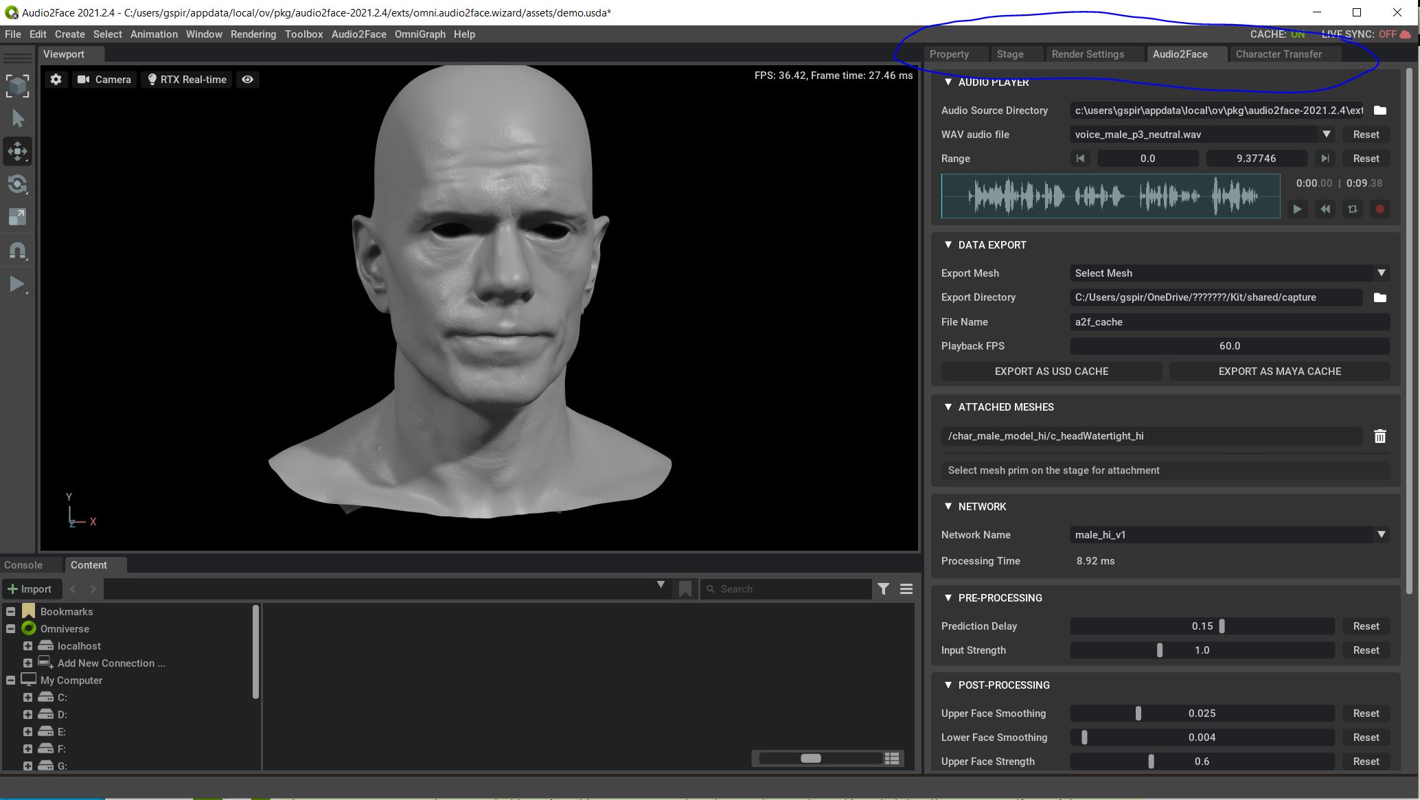

Hello all
Although I have done all the updates, the A2F Data Conversion tab is missing in my Audio2Face app. Any idea what is happening or how to enable it ? I tried at windows tab, but there is no where.
Any help ?
Thank you

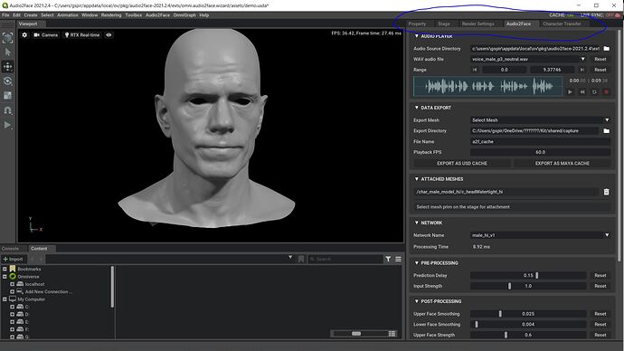

Hi @user105894, thank you for using Audio2Face!
It appears that you are using an old version of the app (the window title on the screenshot says “2021.2.4”).
Please update to the latest “2021.3.2” version via Omniverse Launcher
thank you… Everything works great now!
