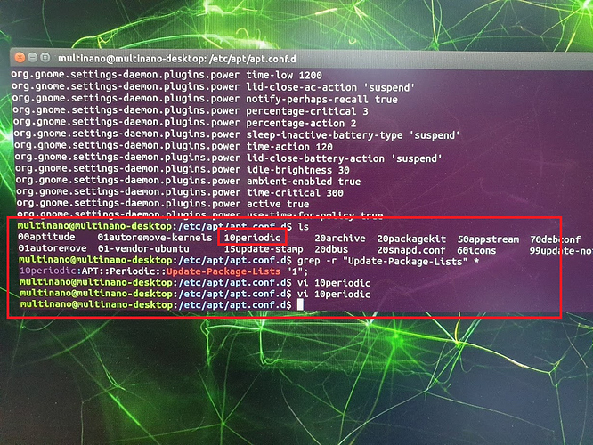

I found this : https://linuxconfig.org/disable-automatic-updates-on-ubuntu-18-04-bionic-beaver-linux
Can the name of the file that manages auto update on Ubuntu (L4T) differ from normal Ubuntu and Jetson Nano?
As you can see in the picture, it looks like we found a flag that turns off auto update with the grep command. Can I edit this file?
Thank you.
…the above is the exact approach most developers use. There will be some default file elsewhere in the operating system. If you find 10periodic somewhere else, or 20auto-upgrades, and you wish to edit that content, then simply copy it to /etc/apt/apt.conf.d/, and then edit there. Removing that file (or just disabling it by compressing it) will revert back to the original behavior. Putting the edited file back in place will produce the modified behavior.
You could also just create the file as you want. I don’t know how to test if this is set, but for example I have:

Looking at the content of 10periodic
It shows a list of updates, but you mean that you don’t actually upgrade?
Thank you.
I upgrade, but I do so manually. I do not want this to run on boot-up. I want this to run when I choose. Probably the time this matters most is right after a new flash…there might be 500 packages to upgrade, and meanwhile, you are trying to do first boot login setup. I always set this up in the “Linux_for_Tegra/rootfs/etc/apt/” area before I ever flash.
