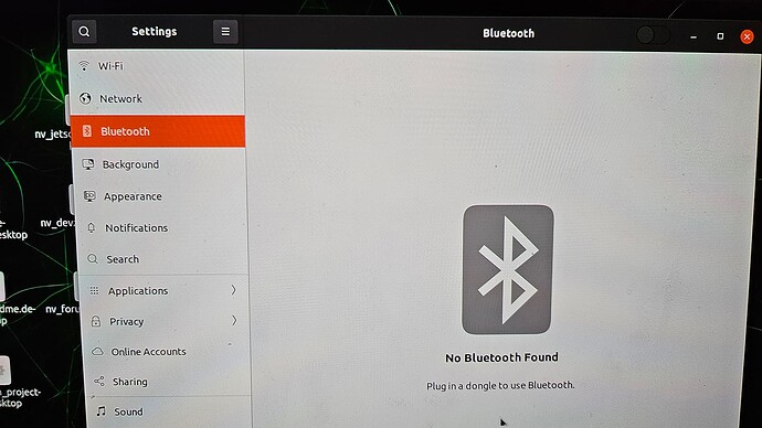

AGX Orin Jetpack 5.1.3 - No Bluetooth Found but Wifi works fine
I have flashed AGX Orin successfully with Jetpack 5.1.3 (twice) on to nvme and even though wifi seems to be working fine, bluetooth isn’t recognized at all and its asking me to plug in a dongle.
Help please…

We test on AGX Orin developer kit with Jetpack 5.1.3 and can connect with Android phone and transfer files. Do you have a phone((either iphone or Android)) for a try?
Yes I have Android device, and happy to test. Can you share instructions?
We follow the Ubuntu GUI step by step. Please go to System Settings to turn on Bluetooth and pair with your device.
Ah you mean connect via bluetooth? As my problem description explains, no Bluetooth is found by Ubuntu, eg see screenshot
Please reboot the system or run sudo rmmod btusb, sudo modprobe btusb and see if it helps. And you can run lsusb to check if it is present:

I ran all the commands you suggested, and rebooted.
IMC Networks Bluetooth Radio is listed in lsusb but Bluetooth is still not found in the settings menu.
Please try other Jetpack versions such as 5.1.2, 6.0GA. If it doesn’t work on all the versions, it may be physically broken.

I think you may have misunderstood the issue. The settings menu won’t allow me to control the bluetooth adapter
I tried another one and had the same problem. In fact I could use Bluetooth in command line and see other devices, but the settings window still says no adapter found.
