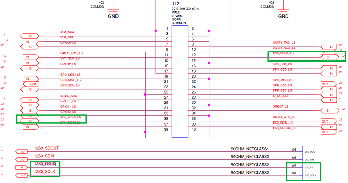

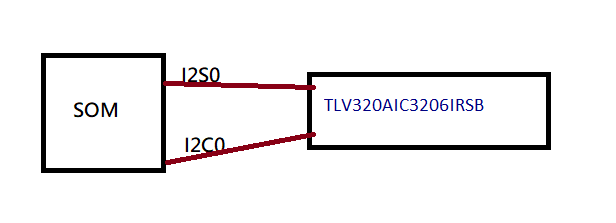

AUDIO does't have BCLK/WCLK
We use I2S0 connect to audio Device, and also use I2C0 too.
It can make sure MCLK is OK, but BCLK/WCLK doesn’t any signal from SOM.
Could you give us some suggest?

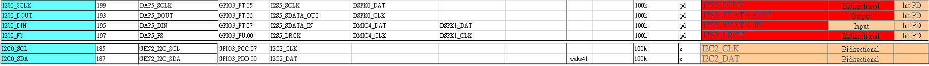

Did you remember to use the correct pinmux for each pin? It should be generated by the pinmux spreadsheet.
Dear Wayne,
Yes, the Audio chip’s connect interface of pinmux table excel as below photo
(Sorry, The forums seems couldn’t upload the whole excel file)
The there’re the dts which generated by excel file.

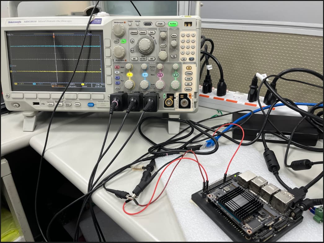

Dear Wayne,
Sorry to reply late, we’ve restore the original bootloader,kernel,rootfs which folder under Linux_for_Tegra/ for a clear environment which we had been tune.
The pinmux table we’re only tune the dap5 to I2S5 as the green block below.
Then validate this I2S interface with oscilloscope, but the BCLK and WCLK seems still no signal/clock so far
( whatever validate it with our carrier board or DeveloperKit, those photo below are validate with DeveloperKit)
