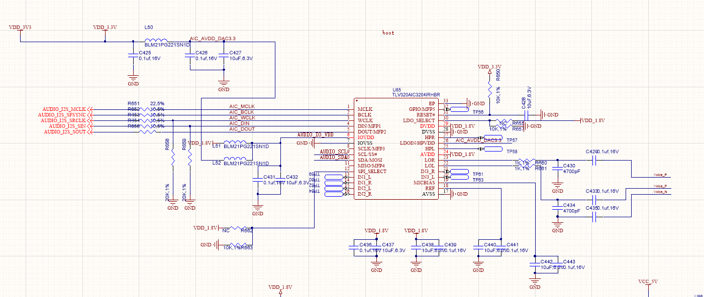

Hi Henry,
From the logs you attached it seems like codec access seems to be failing. There is no direct codec access in aic32x4_probe(). The errors happening in codec_probe() are not captured and thus it goes ahead with registering codec. Can you confirm if you captured the logs with audio card connected?
Since i2cdetect command works, it means I2C bus is working fine. Not sure why you are not seeing signals with oscilloscope.
Please share the changes you made in DTSI file.
Also please share schematics of your audio card connection with TX2.
Hi @spujar
Thanks for your reply.
Yes, the dmesg log was captured with audio card connected.
We modifiled DTSI again, and now signal can be cought on i2c bus 1. The previous error “no acknowledge from address 0x18” has gone, which is comforting.
But the pin7 MCLK still goes flat line on the oscilloscope.
Could you give some advices on how to config MCLK, and how to set frequency.
And dmsg log shows that “Failed to add route x OUT → direct → x Headphone”
[    4.559915] tegra-asoc: sound: ASoC: no source widget found for x OUT
[    4.559917] tegra-asoc: sound: ASoC: Failed to add route x OUT -> direct -> x Headphone
[    4.559936] tegra-asoc: sound: ASoC: no sink widget found for x IN
[    4.559938] tegra-asoc: sound: ASoC: Failed to add route x Mic -> direct -> x IN
according to this topic, shell has been run, and audio debug log has been upload.
Regarde
Henry
FYI
dmesg
henry_tlv01.log (131.7 KB)
audio debug log
tegra-audio-debug.txt (518.7 KB)
DTSI
tegra186-quill-common.dtsi (33.6 KB)
33 Audio.SchDoc (342 KB)
Hi Henry,
Good to know that I2C transactions are good now.
How to open this schematic file? Or you can attach an image file for a quick view.

Hi @spujar
The Audio.SchDoc is edited by AD, so you can open it by Altium Designer. And we captured images for a quick view, which has been uploaded.
Only playback is needed on our project, so mic can be ignored.
