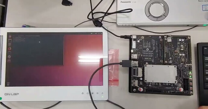

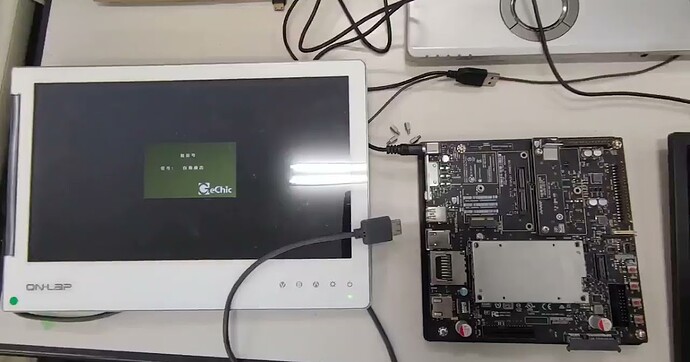

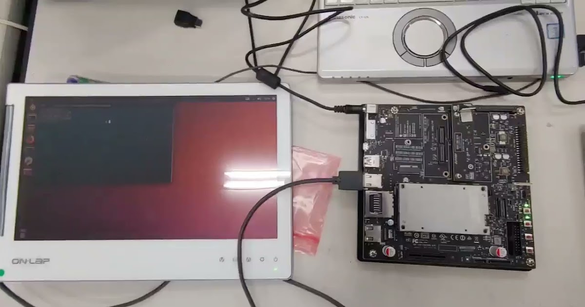

Sorry for the late reply.
I have tried recovering from boot state.
I have a TX2 that has a problem with no video output when booted with HDMI connected. So, I took videos of two patterns, one with HDMI connected from the beginning and one without.
Looks like what you are doing in “part2.mp4” is already correct. When the board is in recovery mode, no OS is running so it is normal that HDMI won’t show anything.
And just a reminder that… do you know that you need to connect the micro usb port to the device?
Yes. I saw it as something to be connected after entering the recovery mode.
However, when I do “lsusb” from another computer, I can’t see the connection.
Also, if I do the same thing as in part 2 without HDMI connected, and then connect HDMI, ubuntu is running.
Therefore, I believe that TX2 is not in recovery mode.
My TX2 does not output video when booted with HDMI connected, even when it is not in recovery mode.
