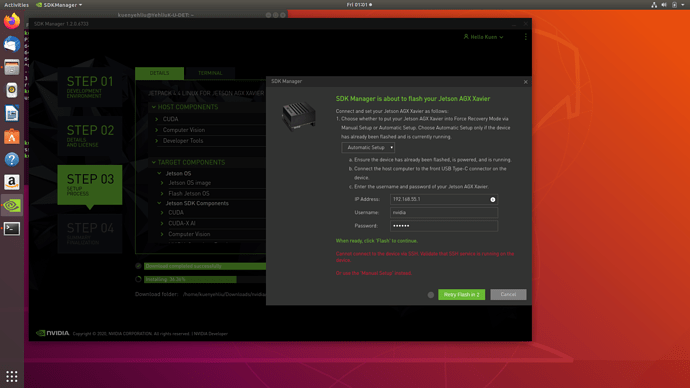

I have a new NVIDIA Jetson AGX Xavier and I am following the JETSON AGX Xavier User Guild to download JetPack 4.4 and install the SDK.
However, I received connection error and I cannot install the SDK. The farther step that I can go is “Flash Jetson OS”. When the SDK Manager attempts to flash Jetson SDK Component, I kept receiving a message “Cannot connect to the device via SSH. Validate that SSH service is running on the device”.
I try to install JetPack 4.2.3, but I receive the same type of error.
Can you please suggestion possible solutions?

The screenshot says 'cannot connect AGX Xavier with acount nvidia:nvidia'.
You should connect a HDMI monitor and a keyboard/mouse to the Jetson AGX Xavier for the first boot-up step.
In the step you would meet EULA, account generation, locale info.
After this initial jobs, SDK manager of host pc can step forward, install remain stuffs.

I had missed the step of going to the screen of Jetson AGX Xavier to set up my account and password. After I configured my account, I was able to install the other SDK packages such as CUDA and completed without errors.
I did not need to configure any IP address manually. The default IPs worked out fine.
Meanwhile, I first connected Jetson AGX Xavier by HDMI/VGA cable to a monitor but it could not work. I saw some text one the screen but it stuck and not entered the Linux configuration menu. That is why I was not aware of the account configuration step at the first place and mistakenly thought I could use nvidia/nvidia for both account and password. After reading your reply and check another post https://forums.developer.nvidia.com/t/problem-flashing-and-booting-xavier/75797 , I tried HDMI/DVI cable with a newer and larger monitor and it worked.
