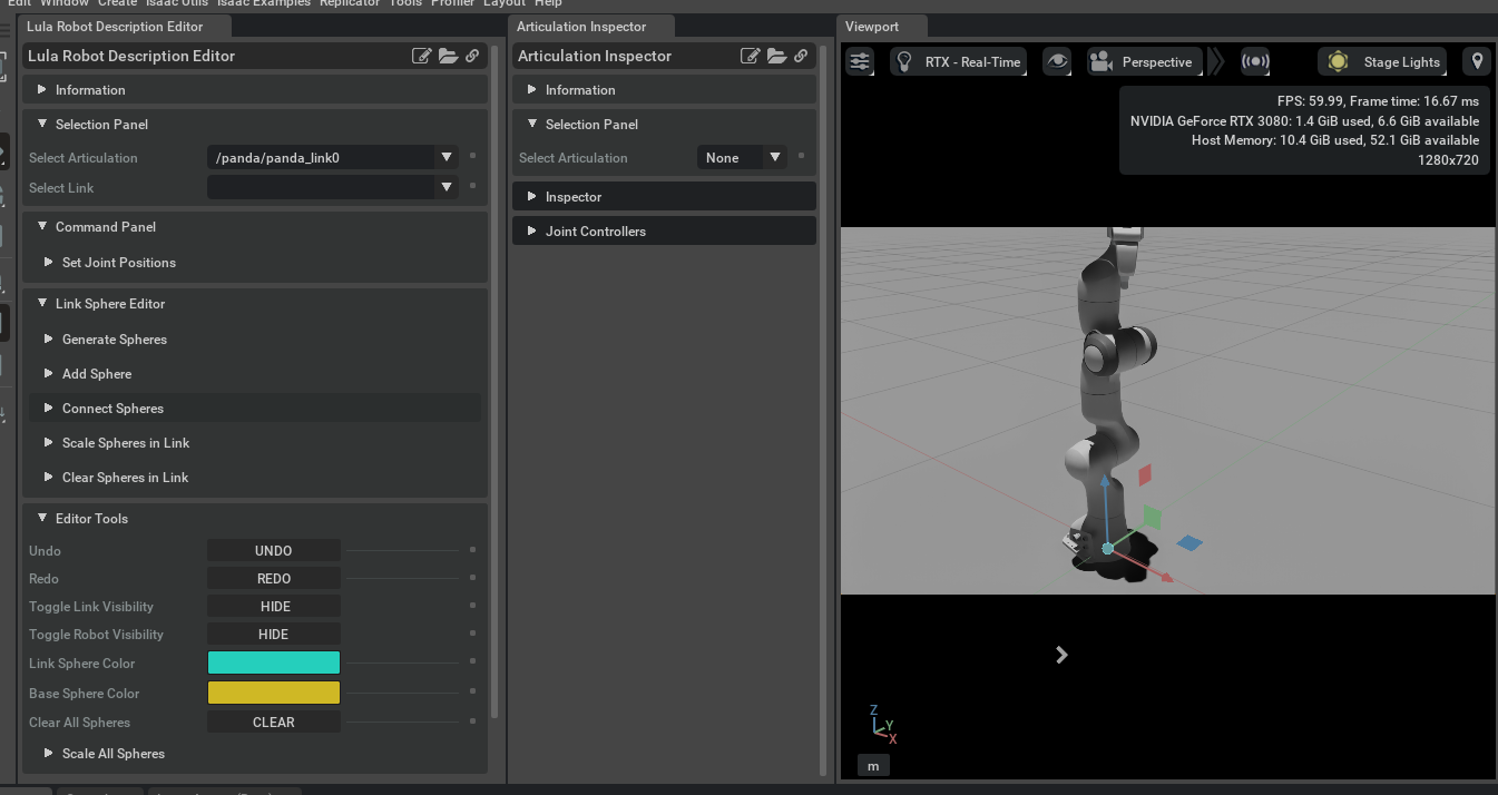

I am trying to generate a yaml file for using motion generator tool. And I am using Lula Robot Descriptor Editor for that purpose. The manipulator I am using is Panda from the Isaac Examples. And I am using Ubuntu 22.
As shown in the picture, At Select Panel > Select Articulation, the selection is /panda/panda_link0. The option is different from the tutorials.
In the tutorials you can select the links in Select Link and only robot name can be selected in Select Articulation, (e.g: Select Articulation: /panda; Select Link: (panda_link0)).
But for my case, Select Articulation: /panda/panda_link0; Select Link: {nothing shown}.

The reason why Select Articulation shows /panda/panda_link0 is that panda_link0 is the Articulation Root. Now we need to fix that. Read the instruction in Tut # 2.4: 2.4. Assemble a Simple Robot — Omniverse IsaacSim latest documentation
So we need to go to Property > Physics delete the wrong Articulation Root by clicking the X mark at the right side and the add the Articulation Root in /panda not /panda/panda_link0.

@hslktestmail It looks like you have noticed a bug arising from changes in the URDF importer where the base path of the Articulation is no longer considered to be the Articulation root, violating some assumptions made in the robot description editor. We are aware of this problem, and it will be fixed in the next release. The best fix for now is indeed to change the Articulation root of the asset back to the base path (this can be done with a copy of your USD file so that its not a permanent change and it will not affect the resulting robot description file)
