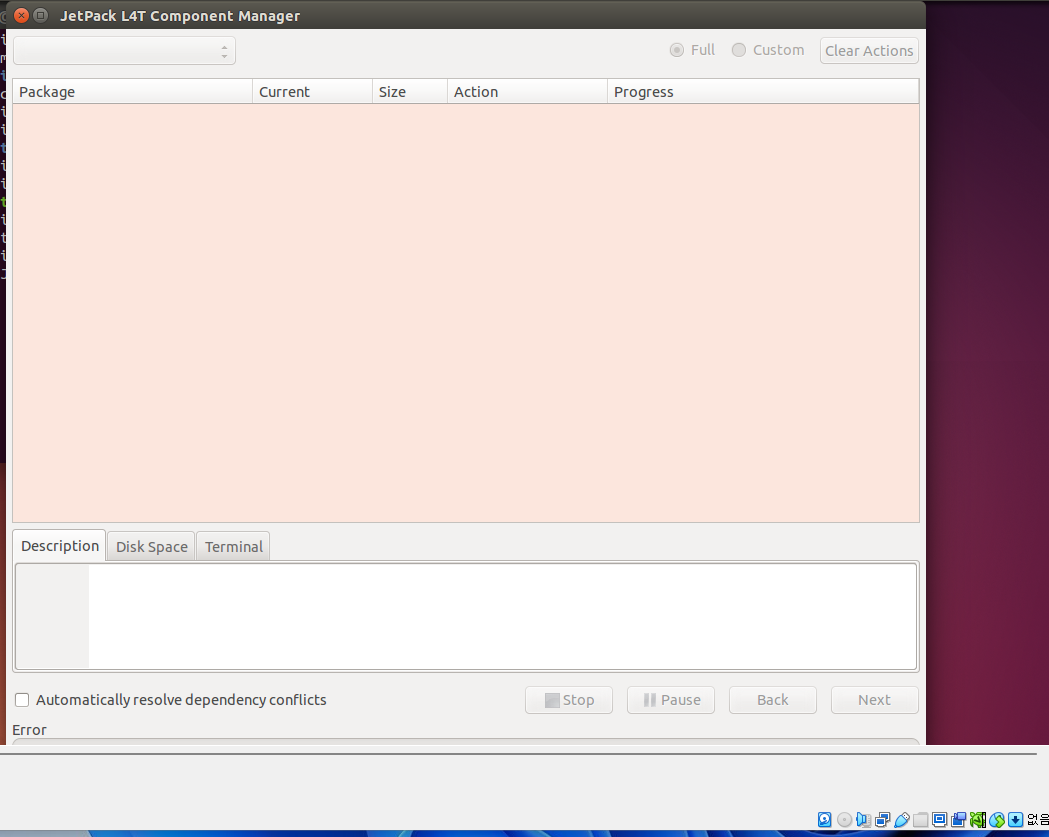

Can't download Jetpack 2.3
Hello.
I found that ZED camera is suitable for Jetpack 2.3, for Jetson TK1 board.
and with latest Jetpack 3.1, wireless driver didn’t work.
I tried to download and install Jetpack 2.3 here :
but download link is not valid.
Because ZED camera is not working on my Jetson TK1 board, Im trying this 2.3 version.
I found Jetpack 3.0 here:
However, when I run it, it doesn’t download the necessary packages.
Is the link broken because ten years have passed?

because It seems that ZED camera SDK is compatible with Jetpack 2.3, I’m trying to install it.
Jetpack 2.3 is r21.5 for TK1. You can download the driver package and sample rootfs from r21.5 webpage.
Hello. Are you reading my questions?
This is not related to the TK1’s firmware. The Jetpack runs on Ubuntu 14.04.
The Ubuntu 14.04 computer will transfer files to the TK1, so the host computer matters.
I listened to you and tried with r21.5, but the result is the same.
r21.5 is just Linux and the kernel; it doesn’t include CUDA or several libraries and samples. It is meaningless if I can’t install Jetpack.
This is the problem I experience :

I solved the problem; R21 is not needed.
The wireless LAN driver worked right after installing the Greench kernel, and the reason the ZED camera didn’t function was due to an obsolete ZED calibration file server.
Thank you very much.
but I think the link should be modified.
