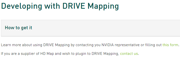

In case we don’t have the HD map about a area. I’m curious whether we could use DriveWorks SDK create a HD map with a sensor vehicle.
Please take a look at https://developer.nvidia.com/drive/drive-mapping and there is some description in “Developing with DRIVE Mapping” section about how to get it.
Thanks @VickNV for your input!
That means, if I want to create a HD map (MyRoute), then I need at least the Map Stream API on vehicle site and a Map Cloud Server what processes the fused data from vehicle. Is that right?
Is Map Stream API a additional package which not included in current DriveWorks SDK?
Best regards
Yes, it’s additional. That’s why you need to follow below section in https://developer.nvidia.com/drive/drive-mapping to contact another nvidia representive. .
