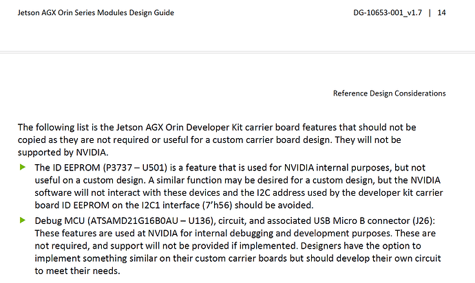

Hello, We are designing a custom carrier board for AGX ORIN. We are refering to your carrier card for this purpose and got stuck with few doubts. We want to ask you the purpose of using Debug MCU (ATSAMD21G16B-AU). Can we omit this device in our card or is it controlling some power sequencing?
sgursal
3
Please refer to Jetson AGX Orin Design Guide
