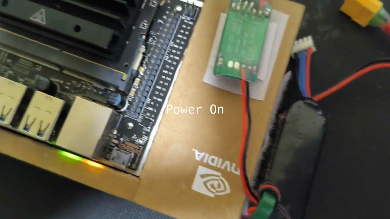

This is just a hope, who knows I am lucky enough to find a tip here which allows me to fix my dead Jetson Nano. It was mostly unused, the day before it was working nicely, I turned it off and then next day it was… well… “dead”.
  • Does not boot
  • Does not light on the green light (except when cutting the power)
  • No video
  • USB does not turn even the eth lights
  • The bar pins do the same thing as the connector used in the video.
I made this short video to show how it is behaving:
If anyone have a minute to look and maybe give me a tip regarding which components can be fried, or if reflashing could save it, anything helps.
Thank you very much.

  1. Please take a photo of how you connect the board. I mean the usb ttl to which pin on Jetson side.
  2. The video seems a little weird. Does the LED on the ethernet port directly becomes on when you power on the board? And the power LED on the board didn’t turn on?

It is weird for me to see the LED on Ethernet port just light up because you power on the board.
Probably a hardware problem.
