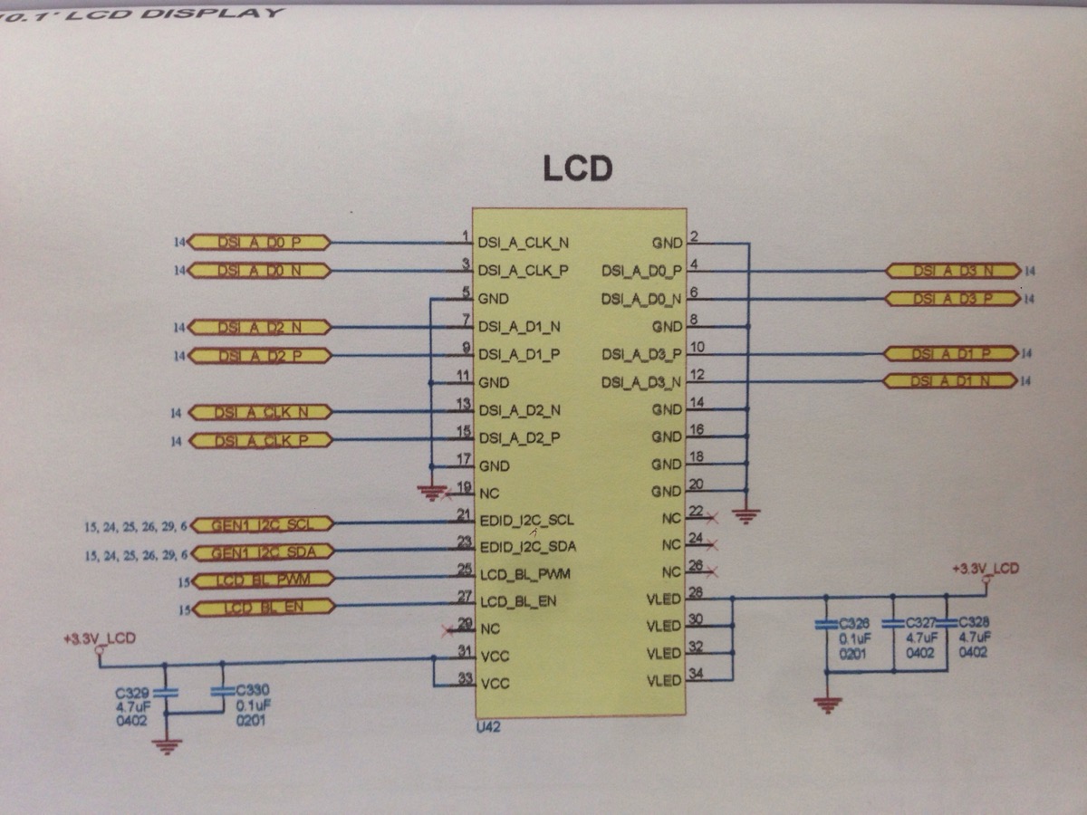

Hi Alex,
Thanks for the detailed description.
I am using panel driver “panel-p-wuxga-10-1.c” and it is included in the kernel itself. It is from L4T. I did not do anything in this file.
In the datasheet, there are not clear but initiating information. I do not clearly understand it.
Here, I attached picture of the circuit diagram for LCD connection to the CPU.
Name of the driver is: panel-p-wuxga-10-1.c
LCD Device is: B101UAN01.7_H/W 1A Datasheet link: http://www.yslcd.com.tw/docs/product/B101UAN01.7.pdf

Hi TulgaD,
I assume that all about electrical connection and power sequencing are OK.
I feel that panel-a drivers may be more suitable for your case.
Taking written above aside as far I see right here taking into account my TX1 experience:
  1. You need to turn on dc@54200000 turned off by default to make DSI work.

It is important to have display-timings section.
My sample is AMOLED and does not have a backlight, but yours has.
  1. Your datasheed does not have DSI registers init sequence, but DT has. Perhaps it is not right.
    Actually you have to ask manufacturer to clarify the DSI init sequence.
  2. I see first time a DSI panel without init sequence, but with I2C EDID. The drivers from the L4T does not have a I2C EDID support. Moreover, all the described registers are I2C ones. But there is nothing about DSI registers. So, datasheet is most strange I’ve ever seen.
Hope it helps.

Hi Chejian,
Can you help me on DSI Driver on Tegra K1? I have tried to integrate AUO MIPI LCD B101UAN01.7 into our customized system based on TEGRA K1 CPU. So far we have checked everything around connection to CPU and its schematics. It seems everything is correct. For the LCD, it has ORISE TECH OCT3108B-HV161 MIPI IC and it is different than usual MIPI LCDs. However, I have contacted with the technical team of AUO and they said this lcd passive type of MIPI LCD. There is no need of initiating code and special sequence. I have enabled TK1 DSI configuration on kernel and changed the values in many different ways according to the Technical Reference Manual of TK1. There is no success at all.
I hope that you can tell us what we do wrong.
Thanks,
TD
