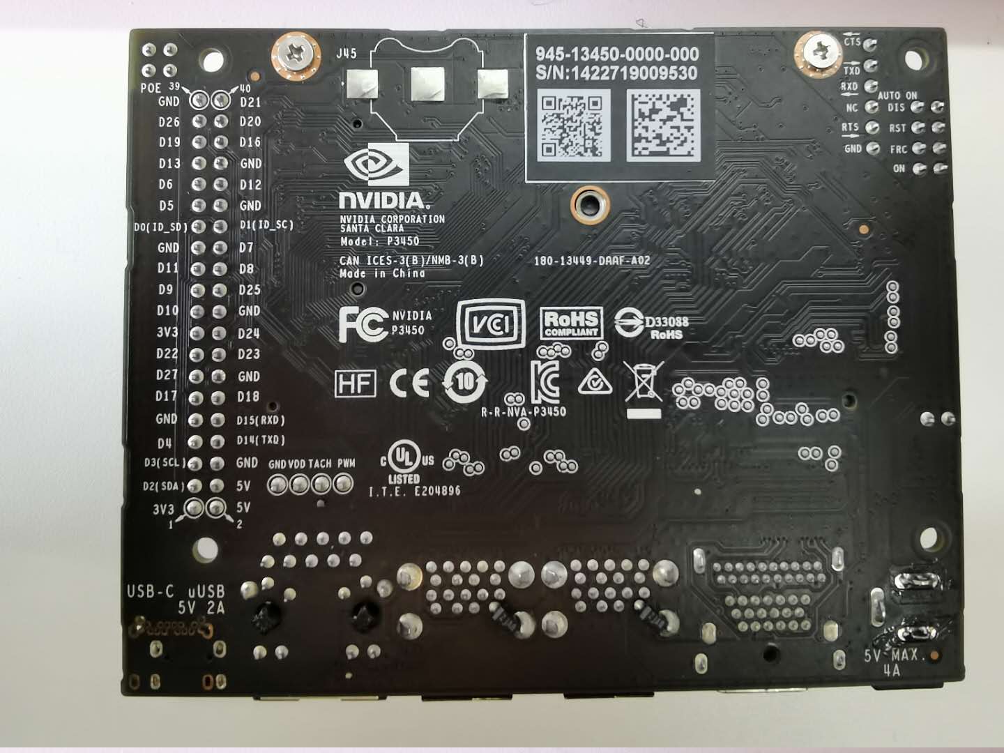

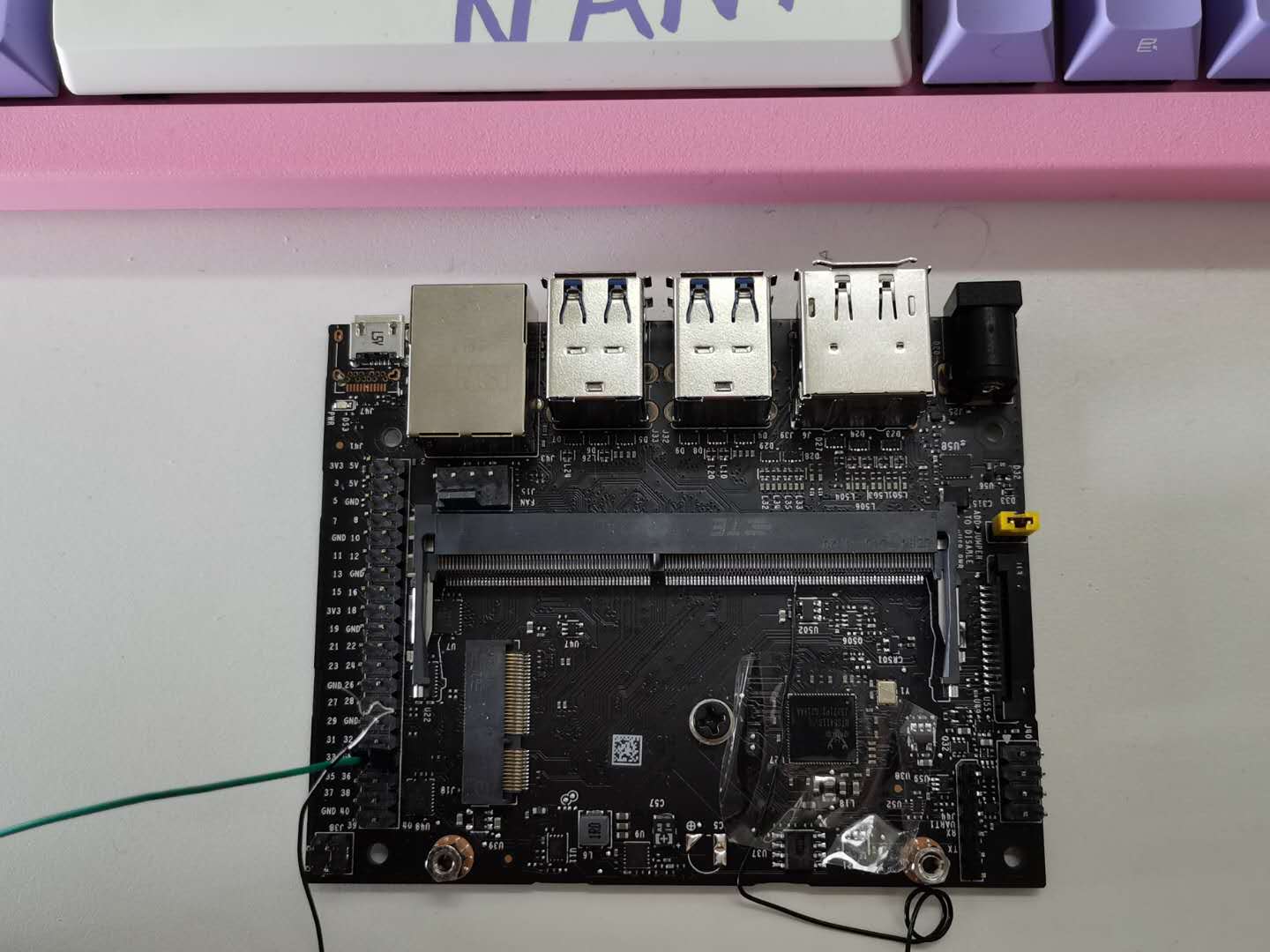

DSI panel initial commands are sent, but there are no signals from pin DSI_D0_P. Any advice?
I want to enable MIPI DSI panel on a homebrew carrier. To make sure whether DSI initial code is sent from Jetson Nano SoM, we measured signals of pin DSI_D0_P on SoM by using a oscilloscope, and use Jetson Nano P3450 as carrier board. During the measurement, we found there are no DSI initial code related signals. The following are the detailed information and we hope to get some advice.
The MIPI DSI panel our homebrew carrier expect to support is a TFT-LCD module has a 8 inches display, contains 800x1280 pixels, and uses JD9365 as Driver IC. The Device Tree we modify is panel-a-wxga-8-0.dtsi. The content of this file is as following. The panel initial code is from line 50 to line 257.

On Jetson Nano P3450, a wire is welded to PIN DSI_D0_P. In pinout of Jetson Nano SoM, DSI_D0_P is pin 72, so we welded a wire on 36th pin at lower side of pin sequence.
And the signals measured by oscilloscope is as following.
While the expected signals is as following, which is provided by DSI panel provider.
So in former figure, there are no DSI initial commands related signals.
Do you have any advice for this issue? Are the DSI initial commands written to wrong addresses?

Do “B01” , “A02” represent carrier board type? At the back of carrier board, there is “180-13449-DAAF-A02”.
Is it type “A02”?
Yes, it is type A02.
Which document mentions Test Points? Document “NVIDIA Jetson Nano Developer Kit_Carrier Board P3449_B01.pdf” doesn’t discuss Test Points.
Current docs in DLC are all for B01, so I marked the TP80 on your picture.
