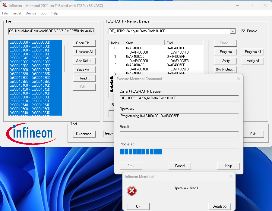

After a weekend I tried to access the board on Monday and something happened to the DRIVE since I’m not able to boot it up. I have the following status around the system:
Led status:
off on on off on on off blinking off
Fans status:
All off
While trying to restart Aurix manually:
NvShell>aurixreset
Info: Executing cmd: aurixreset, argc: 0, args:

I reflashed the Aurix firmware successfully, version: DRIVE-V5.2.6-E3550-AFW-Aurix-With3LSS-StepA-4.04.01.hex using memtool in a Windows machine with Windows 11. This didn’t help at all to fix the not-booting issue in both Xaviers.
I also tried to flash these files in order to be able to run the command showvoltages in my Aurix shell:
DRIVE-V5.2.x-E3550-NV-Aurix-IFW-StepA-1.29.16.hex
DRIVE-V5.2.x-E3550-NV-Aurix-UPDATE-StepA-1.29.16.hex
But the flash process failed:
At this point, I’m stuck with the development on this platform so anybody has experienced this issue after checking all the other forums available here?
