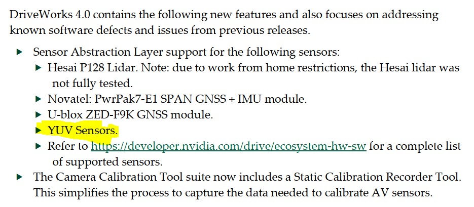

We want to use DriveWorks 4.0 to record camera data with AR0147 sensor. We already have the custom driver for this sensor and it works well with nvsipl_camera application (with -R01 parameters that enable RAW output and disable ISP0/1):
./nvsipl_camera -c "AR0147_DPHY_x4" -m "0x0000 0x0000 0x1111 0x0000" -sR01
However, when running DriveWorks sample_camera application, we got below errors. It seems that the rig file does not have valid value for RAW output. Could we specify the output is RAW and disable ISP0/1 in the rig file?

Hi, @v.tindnt
YUV camera isn’t supported in DW yet. Also, custom cameras (not listed DRIVE Ecosystem - Hardware and Software | NVIDIA Developer) aren’t supported in the forum.
Sorry for any inconvenience.
Could you double check about this since DW4.0 Release Notes said that it supports YUV sensors.

In DriveWorks 4.0, captureOutputRequested isn’t set.
That’s why you encountered the issue and I said it’s not supported. Sorry for not being clear.

Did you mean that it is a DriveWorks 4.0 issue that make the output type is not correctly set for YUV sensor? It seems that we could not set captureOutputRequested flag via DriveWork APIs.

Did you mean that it is a DriveWorks 4.0 issue that make the output type is not correctly set for YUV sensor ? It seems that we could not set captureOutputRequested flag via DriveWork API
Yes. it is issue on DW 4.0.

It is noted that DRIVE OS 5.2.6 and DriveWorks 4.0 Linux are the last software releases planned for DRIVE AGX Xavier / Pegasus based platforms in Drive Download page.
However, are there any plans to release a bug fix for YUV sensor issue? If yes, do you have a timeline for this release?
No, there is no plan for further release. Sorry for any inconvenience.
@VickNV is this issue being resolved in the version of driveos 6.0.0.5 and driveworks 5.8?
Dear @lizhensheng,
Yes. This issue fixed
