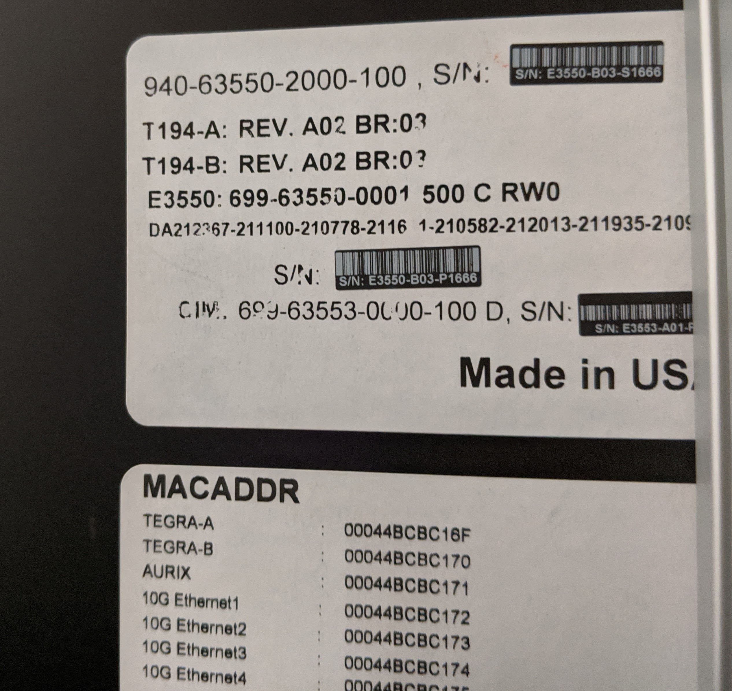

I have compiled some more detail about the issues we are experiencing.
Dev Kit:
We are using a E3550 board
Attached an image of S/N at the bottom of the dev kit.
Software:
DRIVE Software 10.0 (rev.2)
DRIVE OS Linux 5.1.6.1
Camera:
Entron camera mode: F008A120BM0A (ON Semi AR0820 + LCE 120 FOV)
I have 1 camera connected to port A0 (green port on quad camera breakout cable)
Error:
