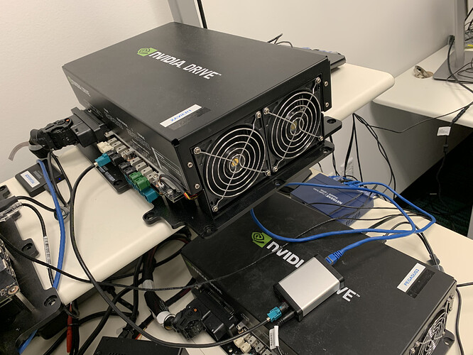

I connected one of the 1000BASE HSD ports through a E3579 Adapter to a Gbit Switch. Later I realized the switch showing the speed as 100Mbps.
I did the following but the speed stills says 100Mbps on the switch :
  • Changed to different port on the switch
  • Changed the Ethernet cable
  • Used another E3579 Adapter
On the both machines the Ethernet says 1000 as we checked

Dear @farid.rajaei,
Could you share the connection detail pictures. Also, could you take a look at https://docs.nvidia.com/drive/drive_os_5.1.6.1L/nvvib_docs/index.html#page/DRIVE_OS_Linux_SDK_Development_Guide/Network%20Setup/network_ethernet_100m_1g.html#wwconnect_header

I am assuming you have connected to Channel B on E3579 dongle. Do you see green color or yellow color on left light indicator of channel B port? Green indicates Ethernet link is running at 1Gbps.
BTW how did you verify the speed?
Hi @SivaRamaKrishnaNV
I am connected to Channel A.
Right light on E3579 is yellow and the left one is blinking Orange (maybe Amber)
The 100Mbps is what my Netgear GS108 Gbit displays another Xavier connected to the same port shows 1G on this switch
Dear @farid.rajaei,
Could you connect to channel B and check the light color as mentioned in https://docs.nvidia.com/drive/drive_os_5.1.6.1L/nvvib_docs/index.html#page/DRIVE_OS_Linux_SDK_Development_Guide/Network%20Setup/network_ethernet_100m_1g.html#wwconnect_header
Using Channel B I am having the similar experience

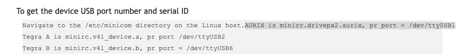

I cannot access ttyUSB1 to access to AURIX prompt as mentioned in https://docs.nvidia.com/drive/drive_os_5.1.6.1L/nvvib_docs/index.html#page/DRIVE_OS_Linux_SDK_Development_Guide/Utilities/util_minicom.html
However I can get to ttyUSB2 and ttyUSB6
Dear @farid.rajaei,
Please use /dev/ttyUSB3 to connect to Aurix. Also, do you see any difference after connecting to other 1Gb HSD ports?
