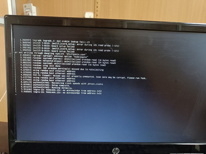

Hi NVIDIA community,
I’m experiencing boot issues with my Jetson Nano. Last time I was trying to run a ML model and it was a heavy task my jetson froze in the process and I had to do the hard reboot. and now when I rebooted it got stuck in the boot loop and During startup, several errors are appearing related to file system corruption and I2C communication. Here’s a summary of the key problems:
  1. File System Corruption (FAT-FS Error):
    I’m seeing the following message during boot:
    FAT-fs (loop0): Volume was not properly unmounted. Some data may be corrupt. Please run fsck.
    It seems like the file system on the SD card is corrupt, and I plan to run fsck to try and resolve it.
  2. I2C No Acknowledge Error:
    The boot log also shows a failure to communicate with a device at address 0x50:
    tegra-i2c 7000c400.i2c: no acknowledge from address 0x50
Error Messages (Excerpt):
4.892659] FAT-fs (loop0): Volume was not properly unmounted. Some data may be corrupt. Please run fsck.
9.905984] tegra-i2c 7000c400.i2c: no acknowledge from address 0x50

Hi prashant.kumar.ug21,
Are you using the devkit or custom board for Jetson Nano?
Have you tried to use another SD card and reflash the board to check if it could help?
I’m using Jetson nano devkit with Jetpack 4.6.1, I tried different SD card and it’s working fine.
With the old SD card it is having boot issue with with corrupt bit’s, I tried reading it from different linux system and I’m able to access those files,
Is there any way I can recover that system?
If something corrupt in your SD card and it can not boot from it, you should reflash it to check if it could help.
I would suggest you back up those files manually if you are able to access them from another linux system. And put SD card back to reflash.
