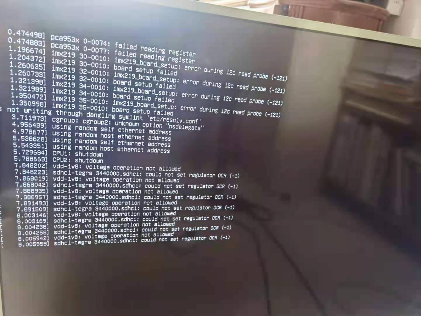

Hi JerryChang,
I could intall Nvidia-Jetpack only after to flash the system again.
Before to install Jetpack the system could be restarted.But after installing Jetpack the system couldn’t go to the Login window and stops at
[ 8.184245] vdd-1v8: voltage operation not allowed
[ 8.184265] sdhci-tegra 3440000.sdhci: could not set regulator OCR (-1)
[ 8.185943] vdd-1v8: voltage operation not allowed
[ 8.185961] sdhci-tegra 3440000.sdhci: could not set regulator OCR (-1)"
But the system could login-in through UART debug console:
Ubuntu 18.04.4 LTS pld-desktop ttyS0
pld-desktop login: "
I couldn’t figure out why Jetpack installlation affected the system start up.data0316a.txt (4.2 KB)

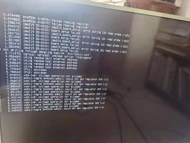

Hi JerryChag,
1,I could install the jetpack without failure now because I reflashed the system image.The system was customized by myself.After the system started,I ran the command to install the jetpack:
$sudo apt-get update
$sudo apt-get install nvidia-jetpack
2,After installing the Jetpack,I restarted the system again.But the system couldn’t go to the login screen.The HDMI monitor displayed the attachment .jpg file always.
3,I could login into the system through ttys0 console and saved the message displayed in the attachment .txt file.And I executed the command through the console:
$ apt list --upgradable
You could check the message in the .txt file after the above command.

hello fangbin,
it shows some not allowed operations.
could you please briefly describe what’s the customization you’d done.
thanks

hello fangbin,
it looks to me an expectation results with a customized carrier board.
since you’ll need customization cfg files to boot-up the board, installing nvidia-jetpack package will overwrite those cfg.
thanks
Hi JerryChang,
1,As I could login in through the ttys0 console,didn’t it mean the board boot-up and the customization cfg was correct?
2,Would you pls. give any clue about what cfg nvidia-jetpack package overwrited?Was it possible to overwrite HDMI related driver?I felt as if the system didn’t output video data to the HDMI monitor.
3,Was there any other way to install nvidia-jetpack?
Thanks,
Fang Bin

Hi JerryChang,
$sudo apt install nvidia-cuda nvidia-opencv
The system could be restarted.
If the following command was executed the system booted but didn’t go to the Login window.
$sudo apt install nvidia-l4t-jetson-multimedia-api
Would you pls. advice about this problem?
