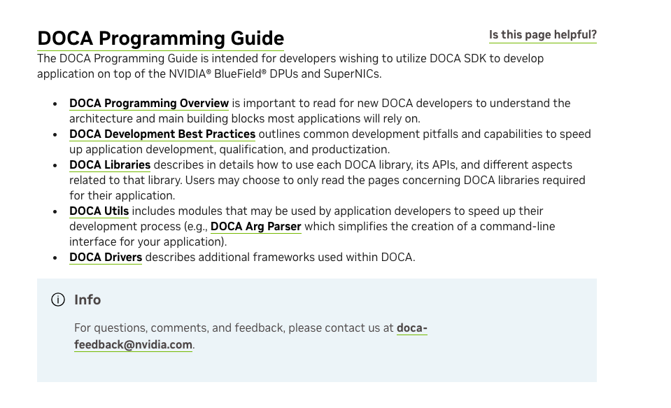

As this is an example of the DPA application code, the following guidance was provided on the main page of the “DOCA Programming Guide”
Please submit your question to the email address provided.
