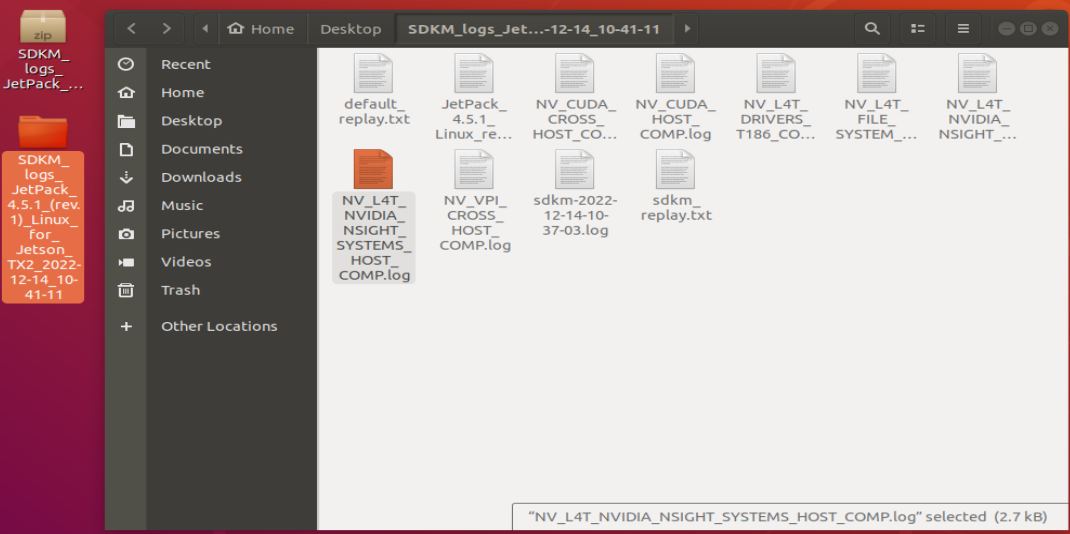

I also taking the screenshot for EXPORT LOGS
below is the the error picture
please review the terminal tab for details. Resolve and Retry
Failed compoent:CUDA on Host
Error: (APT system is broken and requires manual fix)
  • the terminal tab looks like:
ERROR: File System and OS - target_image: command terminated with error
SUMMARY: Device Mode Host Setup in Flash - flash:Depends on failed component
  • the download log/record file I saved on desktop, but not sure will be usefull
for this issue how can I deal with it?
