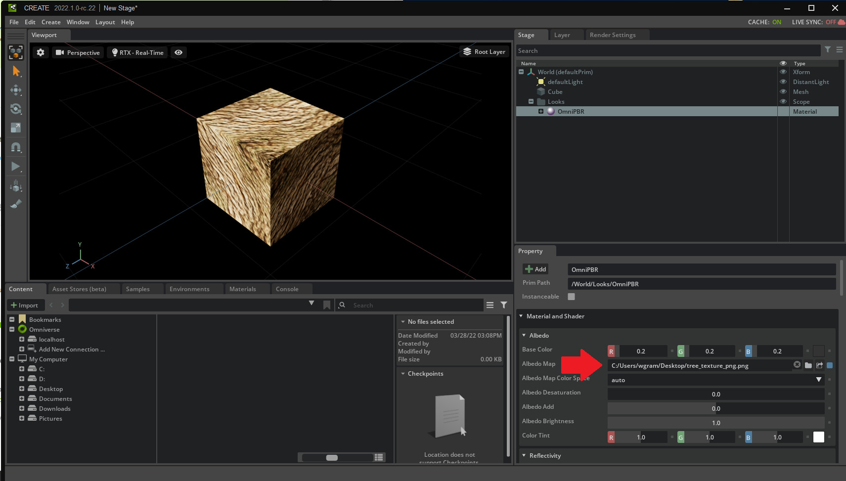

I tried browsing to a .png on my local drive, and drag onto a prop, and nothing happens.
Hello @DataJuggler! Materials have USD properties assigned to them which makes it easy to Drag and Drop material assignments.
You can follow the instructions here: Omniverse MDL Materials — Omniverse Create documentation on how to create materials.
I was able add a .png tree texture on a cube following those instructions.
Let me know if this helped or if you have more questions.

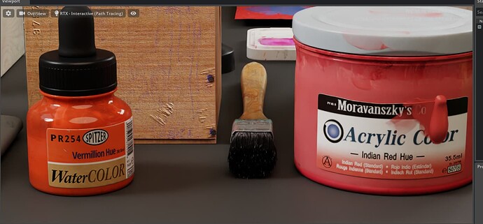

When I look at your props in the Marbles samples, these props looks like they had to come from a texture.
Were the Marbles Sample props created with some of your AI photo wizardry, or do they create a material for props like these?

After clicking Create Material, do I browse for my texture in the Albedo section? Had to look up that word. There are too many options on your create materials tab.
After reading the instructions, I will go with my first impression. I don’t want a material, your system seems to work with Materials and not png files, which is what I understand.
