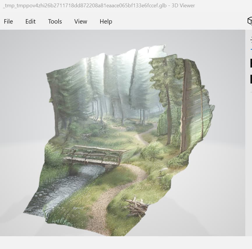

I have a GLB file created using https://huggingface.co/spaces/shariqfarooq/ZoeDepth - upload a 2D image
and it creates a 3D version. A bit of fun. I can open in an online GLB viewer (but not another). I can open it in the Windows “3D viewer” (double click on GLB file and it opens, with texture).
When I open in Blender, there is no material (its all grey). When I convert and open in Omniverse there is no material.
So clearly the texture is in the file, but in a way not everyone supports.

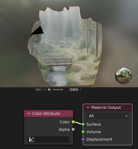

after some tinkering, the method ZoeDepth seems to be using isn’t too dissimilar to camera projection technique. specifically, they’ve positioned a camera at the world 0,0 using a 35mm lens (approx). in short, the downloaded mesh has a pretty messed up UV (outside of the 1 by 1 UV square, upside down, overlapped, etc) and not sure if it’s by design:
but if you were to make the projection after the fact in your DCC, like Blender or, in my case, 3DS Max, you can see the generated mesh stays only within the confines of the camera cone:
unfortunately i am not familiar with the GLB to say how we can extrapolate it from the file downloaded from ZoeDepth (Max didn’t show any materials either). but because the UV isn’t set up properly, Composer will have a hard time replicating the resulting image, and you will likely need to go through a DCC that supports camera projection. here’s what the UV should’ve looked (the mesh is too dense to see, but it should just be a rectangle):

I got the Omniverse version of Blender to show the texture by creating a material, but exporting to USD does not save any texture files.
There appears to be no UV (ST) mapping data in the USD file. So yes, that seems to be the problem. Somehow need to convert projection views into UV maps. More Blender tutorial viewing!
I tried following a few tutorials, and suddenly it started generating generating UV mapping which I managed to get a material created for manually. I need to track it down so I can repeat the process reliably, but an indication of what is possible. Generative AI for 3D Scene Backgrounds – Extra Ordinary, the Series
