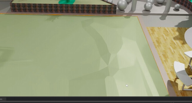

See, this is a Revit file that is exported to USDZ with the SimLab usdz exporter plugin:
How can I make that large green grass field to be smooth?
Or is the smooth surface option ON all the time, and this object simply does not have enugh information to look smoother in Kit 108 RTPT ?

There should be a subdivision option when you select the mesh under Geometry
But in this case there is not..
I tried to play with that setting. No change of the surface..
Am I missing something?
You may have to fix it in Revit first. Or another package. I will try to investigate it.
Ok I have figured it out. You have to select the geometry, and go down to Refinement and engage it. Then select SMOOTH

But there must be something else also activated, see:
I have the USD flle here for you:

@pekka3 upon inspecting the floor prim, 90% of the polygons that make up this mesh are not welded to adjacent faces. my experience is to fix it by welding verts in DCCs but would be good to know if this is even possible in kit.
Ooh - it must be this!
So the official Revit sample file has this kind of flaw. Very good that you and Richard help to see the true origin of the issue and find a solution for it.
I will write to Revit support about this, and ask for instructions to weld the vertices in Revit.I bet there is no such modeling tools in kit..

Ok good to know. I am closing this as a solution. Not an Omniverse issue.
