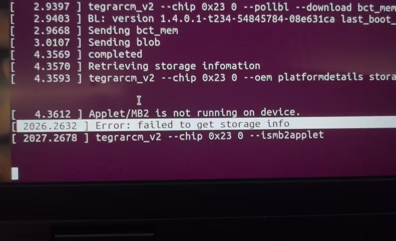

如果烧录不用jetson-orin-nano-devkit-nvme.会烧录失败,报错log提示找不到storage信息;
我使用的烧录命令:./flash.sh jetson-orin-nano-devkit external
后面我在论坛上看到使用jetson-orin-nano-devkit-nvme会成功,我将烧录命令改为:
./flash.sh jetson-orin-nano-devkit-nvme internal
确实烧录成功了,如果需要重新烧录,我再用论坛中看到的命令尝试重新烧写一下:
sudo ./tools/kernel_flash/l4t_initrd_flash.sh --external-device nvme0n1p1   -c tools/kernel_flash/flash_l4t_external.xml -p "-c bootloader/t186ref/cfg/flash_t234_qspi.xml"   --showlogs --network usb0 jetson-orin-nano-devkit internal
