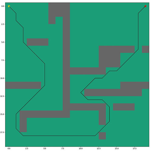

How to move the vehicle to its destination by using A*_search_algorithm
Hi @gudwnzm
Here you can find a simple and quick integration of the A* algorithm (code from the next blog) with the Isaac Sim Navigation Sample
The modification is done in the simple_robot_controller.py file (...exts/omni.isaac.demos/omni/isaac/demos/utils/simple_robot_controller.py)
simple_robot_controller.py (15.2 KB)

# 1. +++++++++++++++++++++++++++++++++++++++++++++++++++++++++++++++++++++++++
import heapq
import matplotlib.pyplot as plt
from scipy.interpolate import interp1d

def heuristic(a, b):
    return np.sqrt((b[0] - a[0]) ** 2 + (b[1] - a[1]) ** 2)
def astar(array, start, goal):
    neighbors = [(0,1),(0,-1),(1,0),(-1,0),(1,1),(1,-1),(-1,1),(-1,-1)]
    close_set = set()
    came_from = {}
    gscore = {start:0}
    fscore = {start:heuristic(start, goal)}
    oheap = []
    heapq.heappush(oheap, (fscore[start], start))
    while oheap:
        current = heapq.heappop(oheap)[1]
        if current == goal:
            data = []
            while current in came_from:
                data.append(current)
                current = came_from[current]
            return data
        close_set.add(current)
        for i, j in neighbors:
            neighbor = current[0] + i, current[1] + j
            tentative_g_score = gscore[current] + heuristic(current, neighbor)
            if 0 <= neighbor[0] < array.shape[0]:
                if 0 <= neighbor[1] < array.shape[1]:
                    if array[neighbor[0]][neighbor[1]] == 1:
                        continue
                else:
                    # array bound y walls
                    continue
            else:
                # array bound x walls
                continue
            if neighbor in close_set and tentative_g_score >= gscore.get(neighbor, 0):
                continue
            if  tentative_g_score < gscore.get(neighbor, 0) or neighbor not in [i[1]for i in oheap]:
                came_from[neighbor] = current
                gscore[neighbor] = tentative_g_score
                fscore[neighbor] = tentative_g_score + heuristic(neighbor, goal)
                heapq.heappush(oheap, (fscore[neighbor], neighbor))
    return False

            # 2. +++++++++++++++++++++++++++++++++++++++++++++++++++++++++++++++++++++++++
            start = (int(self.current_robot_translation[0] / distance_per_square),
                     int(self.current_robot_translation[1] / distance_per_square))
            goal = (int(x / distance_per_square), int(y / distance_per_square))
            route = astar(grid, start, goal)
            route = route + [start]
            route = route[::-1]
            x_coords = []
            y_coords = []
            for i in (range(0,len(route))):
                x_coords.append(route[i][0])
                y_coords.append(route[i][1])
            points = np.stack((x_coords, y_coords), axis=1)
            distance = np.cumsum( np.sqrt(np.sum( np.diff(points, axis=0)**2, axis=1 )) )
            distance = np.insert(distance, 0, 0)/distance[-1]
            interpolations_methods = ['slinear', 'quadratic', 'cubic']
            alpha = np.linspace(0, 1, len(route) * 50)
            print(alpha.shape)
            interpolator =  interp1d(distance, points, kind="quadratic", axis=0)
            x, y = interpolator(alpha).T
            # plot map and path
            fig, ax = plt.subplots(figsize=(5,5))
            ax.imshow(grid, cmap=plt.cm.Dark2)
            ax.scatter(start[1],start[0], marker = "*", color = "yellow", s = 200)
            ax.scatter(goal[1],goal[0], marker = "*", color = "red", s = 200)
            ax.plot(y_coords,x_coords, color = "black")
            ax.scatter(y, x, color = "red")
            plt.show()
            self.cx = x
            self.cy = y
            self.ck = np.ones_like(self.cx)

There are basically 2 changes indicated between +++++ and ------
  1. the A* start algorithm and the grid. The grid is 20x20 and for the integration, I use a mapping of 25cm per grid square side. The obstacles in the grid are fixed and they are there only to showcase
  2. Calling the planer and configuring some variables for navigation. Note that A* is only a path search algorithm. It does not take care of setting the robot velocity setpoints to reach the goal. Current integration set some values required for the last task to 1 or 0 (because the idea is to show the use to the A*)… You have here room for improvement on which to work :)
