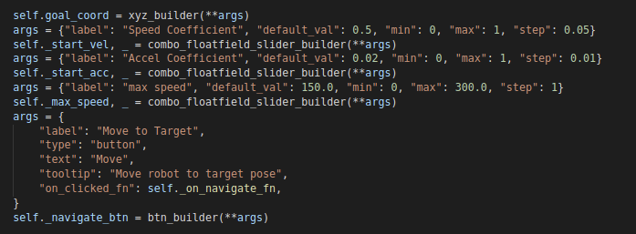

                            args = {"label": "Speed Coefficient", "default_val": 0.5, "min": 0, "max": 1, "step": 0.05}
                            self._start_vel, _ = combo_floatfield_slider_builder(**args)
                            args = {"label": "Accel Coefficient", "default_val": 0.02, "min": 0, "max": 1, "step": 0.01}
                            self._start_acc, _ = combo_floatfield_slider_builder(**args)
                            args = {"label": "max speed", "default_val": 150.0, "min": 0, "max": 300.0, "step": 1}
                            self._max_speed, _ = combo_floatfield_slider_builder(**args)

    def _on_move_fn(self):
        print("Moving forward")
        self._rc.control_command(9, 9)
    def _on_rotate_fn(self):
        print("Rotating in-place")
        self._rc.control_command(3, -3)
    def _on_navigate_fn(self):
        goal_x = self.goal_coord[0].get_value_as_float() * self._stage_unit
        goal_y = self.goal_coord[1].get_value_as_float() * self._stage_unit
        goal_z = self.goal_coord[2].get_value_as_float()
        max_speed = self._max_speed.get_value_as_float() * self._stage_unit
        print("Navigating to goal ({}, {}, {})".format(goal_x, goal_y, goal_z))
        sv = self._start_vel.get_value_as_float()
        sa = self._start_acc.get_value_as_float()
        gv = sv  # self._goal_speed.get_value_as_float()
        ga = sa  # self._goal_acc.get_value_as_float()
        self._rc.set_goal(goal_x, goal_y, math.radians(goal_z), sv, sa, gv, ga, max_speed)
        self._rc.enable_navigation(True)

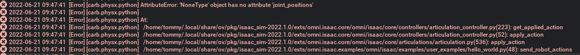

I want to copy the Omniverse example, Adding Multiple Robots, and apply it to my robot.
But I keep causing the same error.
Compared to the example robot, jetbot.usd," and my robot, the joint is not much different.
If I look at the error, I don’t think I can get the joint_position.
The code takes the robot’s position value and puts it in the goal_position, but this part seems to be a problem.
The error contents and code are as follows.

Hi @toni.sm
I haven’t solved the problem yet.
Even though the left_wheel_joint and right_wheel_joint of Jetbot and my robot are the same, the problem still occurs.
First of all, what I want to do with my robot is to put up several robots and arrive at the destination without algorithms.
So I’m starting by customizing it by referring to an example of Adding Multiple Robots.
Help me.
https://docs.omniverse.nvidia.com/app_isaacsim/app_isaacsim/tutorial_core_adding_multiple_robots.html
Hi @gudwnzm
Make sure that the joints of your robot have the angular drive property established.
By the way, don’t forget to update the wheel_radius and wheel_base values for your model :)
