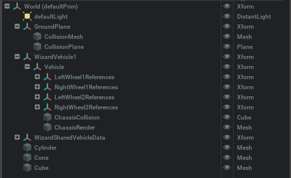

Hello, I scanned my vehicle using the Vehicle Dynamics extension provided by omniverse.
And I want to move my scanned vehicle to the desired destination using python coding.
As shown in the screenshot below, I want my vehicle to automatically move to Cylinder when I press Keypad 1, Cone when I press 2, and Cube when I press 3.
I would appreciate it if you could give me an example or code of how I can do it.
