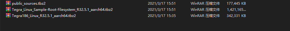

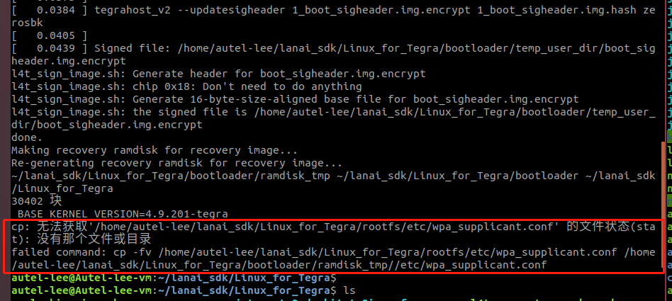

Hi:
I have update the SDK to latest version,but cant bring up the board(sudo ./flash.sh jetson-xavier-nx-devkit-tx2-nx mmcblk0p1), do we have some flashing guide for TX2 NX?

we had confirmed with JetPack-4.5.1, it can flash TX2 NX through SDKManager,
