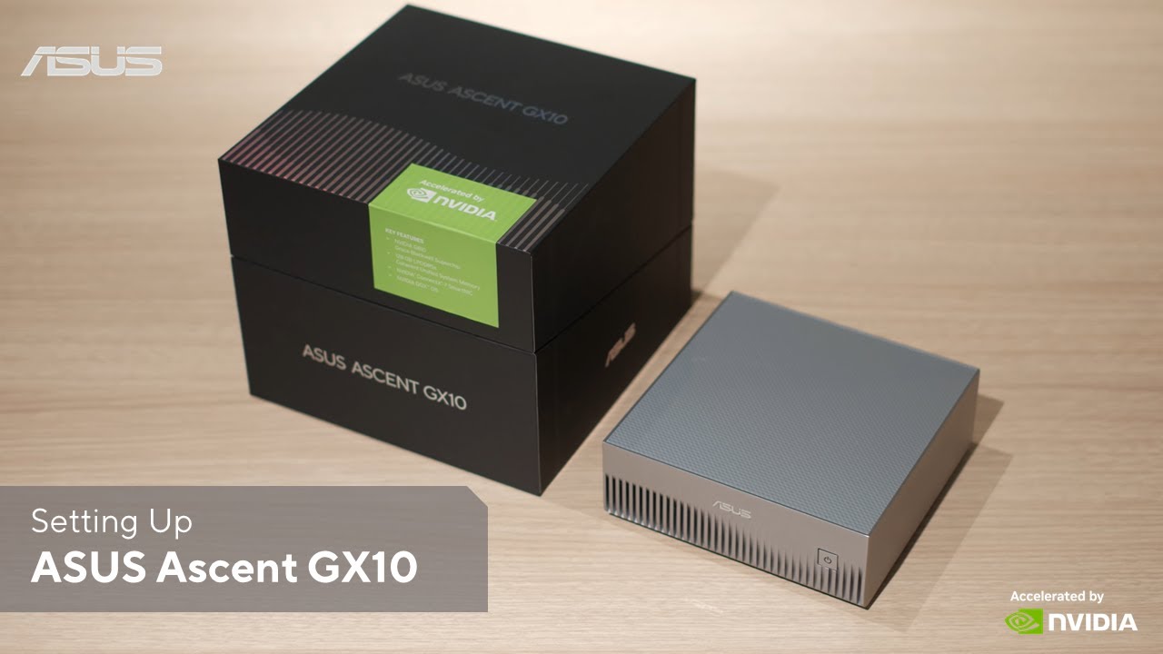

ASUS has included a power switch with an LED in their version. Just stumbled upon their first steps video.
It looks rather inconspicuous, though.
