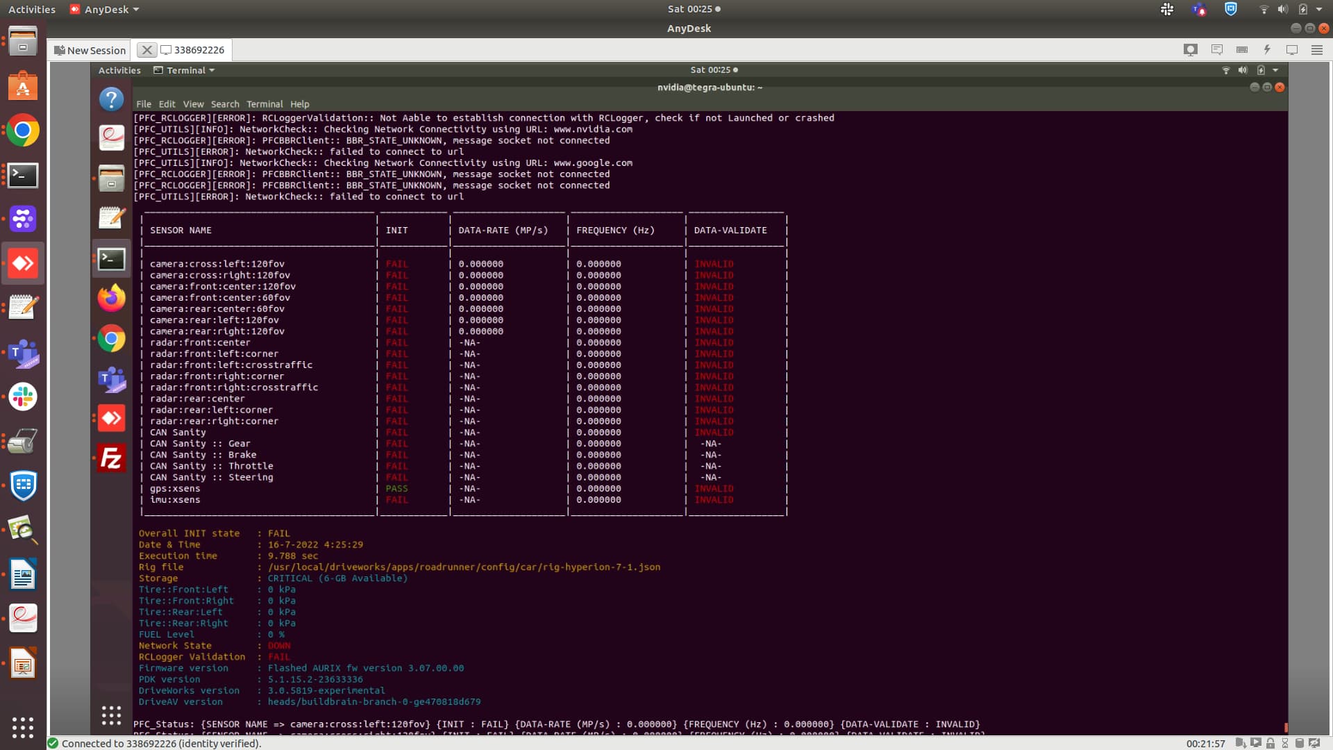

Our Hyperion 7.1 Hardware suddenly stopped working and currently I am debugging the camera side of things. When running the roadrunner app, a Camera no Detected message appears on screen so I am checking the sample_camera_gsml_custom output to start with:

Questions:
Is it an I2C problem? It seems the power command is not successfully transmitted for camera power.
How all the cameras can be affected and not be able to stream frames? Is the deserializer engine hardware bad?
Any suggestions to debug further about this issue?
