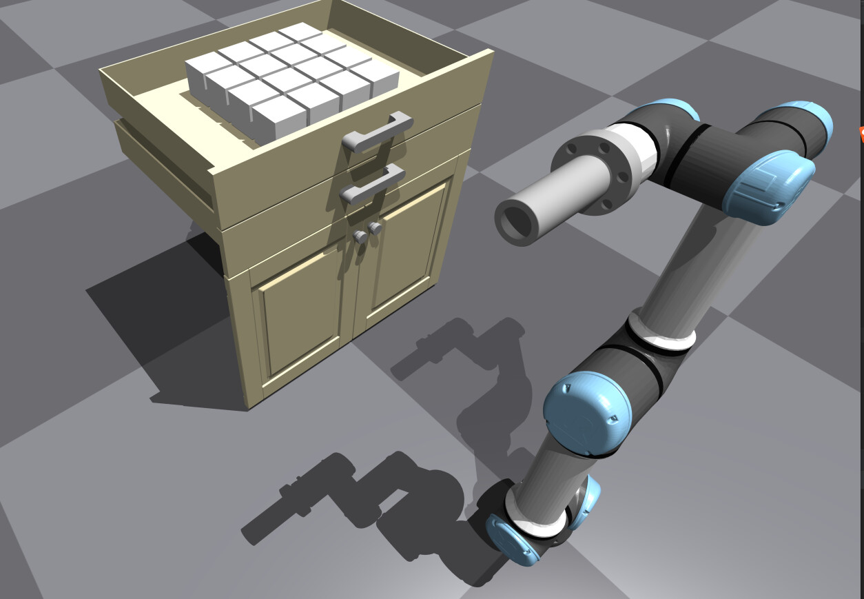

Hi there.
I’m looking for a workaround for this problem. I am using “box” and “cylinder” in URDF file. The box(plate-shaped box on the left) may get a little in the cylinder, but if you increase the “substeps”, it may be in good condition. In the figure below, the holes were created in 5 boxes. It was difficult to fine-tune the angle.

That is true. I am trouble in creating a cylinder hole. As you can see in figures below.That is too difficult.
