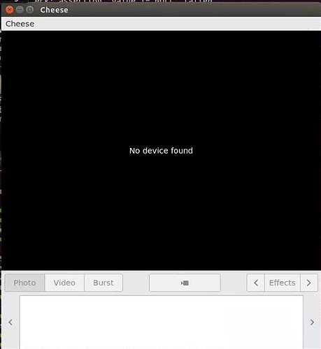

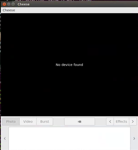

hi, add some information
my device is jetson TX2 nx,
jetpack:4.6.4
the camera is USBcamera, not csi camera
if i run “ls /dev/video*”, i can get “/dev/video0”
but cheese can not finnd device
I’d appreciate it if anyone could help me
Does the camera work outside of the container?
Hi, thanks for your replay!
The camera works outside the container
Hi, Add some information
this picture is outside the container
this picture is in the container
It looks like the camera mounted is correct.
Would you mind validating this by running the GStreamer command inside the container?
If it works well, the cause should come from the cheese.
